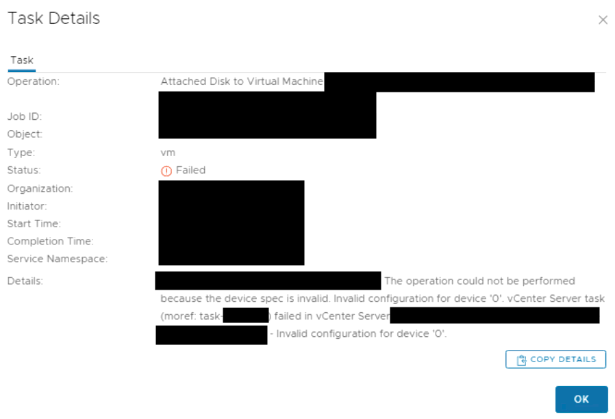

  1. The following error is observed in the task details:
  2. This error happened while attaching a disk to a VM as the datastore where the disk is stored is not available from the host where the VM is registered

    java.util.concurrent.ExecutionException: com.vmware.ssdc.library.exceptions.VimInvalidDeviceSpecException: The operation could not be performed because the device spec is invalid. Invalid configuration for device '0'.
    vCenter Server task (moref: task-########) failed in vCenter Server '##############' (##########-####-####-####-###########).
    Caused by: (vim.fault.InvalidDeviceSpec) {
