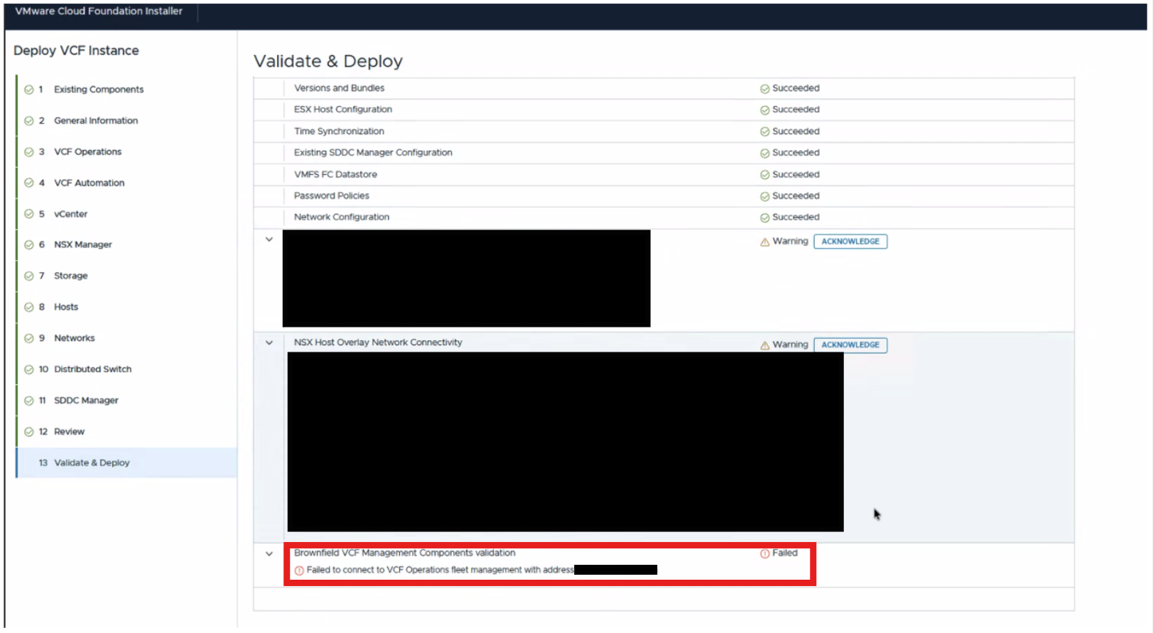

When attempting a VMware Cloud Foundation (VCF) 9.0.2 Brownfield Deployment, the process fails during the validation phase. Specifically, you may observe the following symptoms:
  • The deployment fails at Step 13: Validate and Deploy during the Brownfield VCF Management Components validation.
  • An error is thrown indicating an inability to connect to VCF Operations fleet management.

To resolve this issue, you must update the VCF Installer with the correct credentials for VCF Operations fleet management.
  1. In the VCF Installer UI, navigate back to Step 3 (VCF Operations).
  2. Update the administrator credentials, ensuring that the correct password is provided for VCF Operations fleet management.
  3. Proceed forward through the VCF Installer steps to return to Step 13.
  4. Re-run the Validate and Deploy process.
Providing valid credentials resolves the 401 Unauthorized condition, allowing the domainmanager to successfully query the /lcm/lcops/api/v2/settings/system-details API endpoint and pass the connectivity validation.
