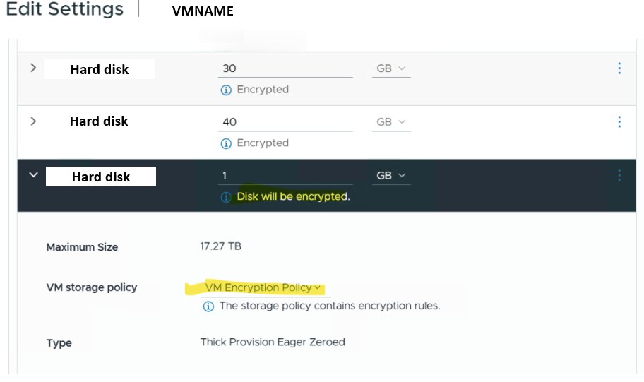

  • Policy set on the hard disk but the disk will not encrypt.
  • Removing the disk encryption policy fails to save the default policy.
  • Disk shows "Disk will be encrypted":
  • Log signature looks similar to the below snippets.

VMware vCenter Server 8.x
NoAssociatedProfileException occurs when a VM/disk is created directly inside the host without the knowledge of vCenter.
On the vCenter UI, remove the disk 15 and then add it back.
VM displayed an inconsistent storage policy status
