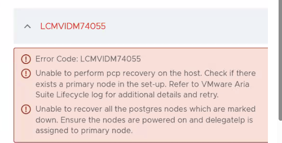

  • When attempting to remediate VMware Identity Manager (vIDM) environment through VMware Aria Suite Lifecycle (formerly vRealize Suite Lifecycle Manager), the operation fails with the following error:
Error Code: LCMVIDM74055

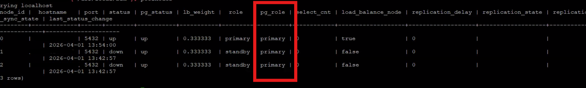

  • 'poolnodes' command shows primary role for pg_role on all nodes

  • Running the poolnodes command shows that multiple nodes (or all nodes) are reporting a pg_role of primary.

  • Verify the cluster status again using:
    poolnodes
  • Confirm that only one node is primary and all others are standby.
