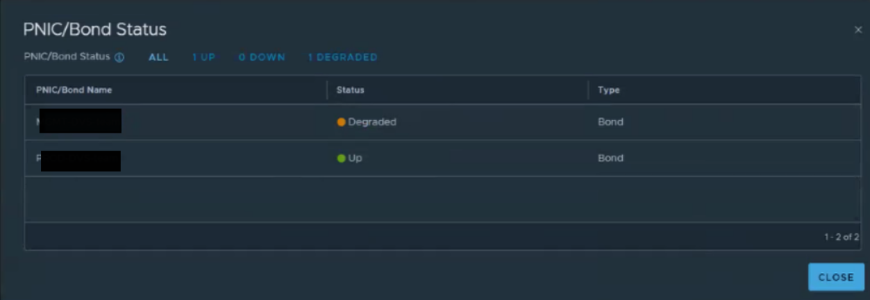

  • Navigate to System > Fabric > Nodes > Host Transport Nodes. The affected host displays a status of Degraded.

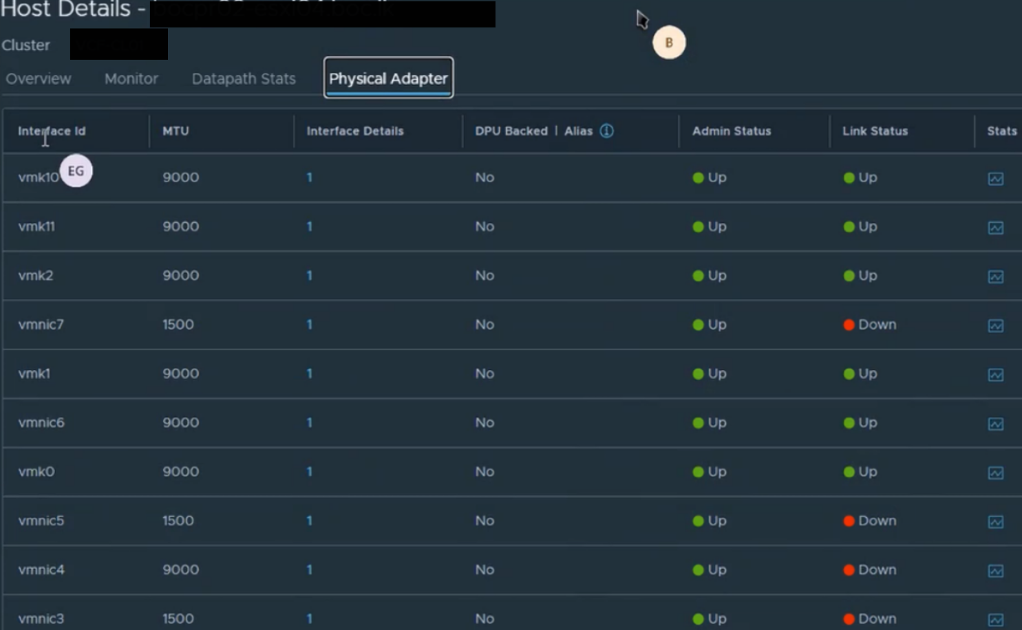

  • Connectivity Check: Physical uplinks associated with the host's Virtual Distributed Switch (VDS) or N-VDS are reported as Down.
  • Service Status: The L2QueryService is unreachable because the transport path between the Manager and the Host agent is broken.

  1. Physical Layer Restoration: Coordinate with the physical networking team to inspect cables, SFPs, and Top-of-Rack (ToR) switch ports. Ensure the links are administratively Up and signaling correctly.
  2. Verify Host Health: Once physical connectivity is restored, log into the NSX UI and confirm the Host Transport Node status has transitioned from Degraded to Success/Up.
