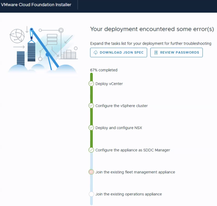

New VCF Instance deployment into existing VCF Fleet fails with a VCF Installer UI ERROR: Failed to poll status for VCF Operations fleet management deployment
Article ID: 435837
VCF Operations
Retrying the task from the VCF Installer UI fails with a similar error, and the deployment is failed at the stage "Join the existing fleet management appliance."
