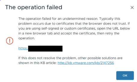

  • While uploading ISO files to a datastore via the vSphere Client encounter the following error:
    The operation failed for an undetermined reason. Typically, this problem occurs due to certificates that the browser does not trust. If you are using self-signed or custom certificates, open the URL below in a new browser tab and accept the certificate, then retry the operation.
