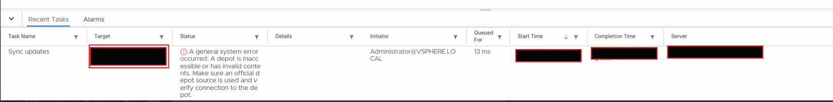

When attempting to perform a **Sync Updates** task in vCenter Server Lifecycle Manager (vLCM), the task fails with the following error in the vSphere Client:
`A general system error occurred: A depot is inaccessible or has invalid contents. Make sure an official depot source is used and verify connection to the depot.`
