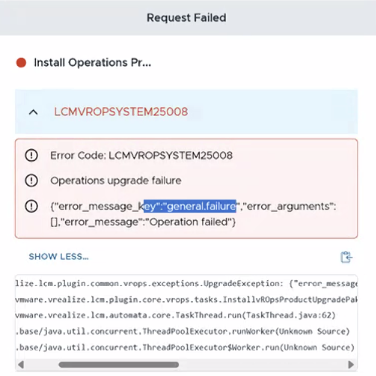

  • In the Fleet Management UI, you will notice an error code 'LCMVROPSYSTEM25008'.
  • Under Fleet Management /var/log/vrlcm/vmware_vrlcm.log, you will notice the upgrade failure errors as shown below:
YYYY-MM-DDT04:18:31.835Z ERROR vrlcm[1219] [pool-3-thread-85] [c.v.v.l.p.c.v.t.InstallvROpsProductUpgradePakTask]  -- VMware Aria Operations product (application) upgrade failed
YYYY-MM-DDT04:18:31.835Z INFO vrlcm[1219] [pool-3-thread-85] [c.v.v.l.p.a.s.Task]  -- Injecting task failure event. Error Code : 'LCMVROPSYSTEM25008', Retry : 'true', Causing Properties : '{ CAUSE :: VAFileName ===  }'
com.vmware.vrealize.lcm.plugin.common.vrops.exceptions.UpgradeException: {"error_message_key":"general.failure","error_arguments":[],"error_message":"Operation failed"}

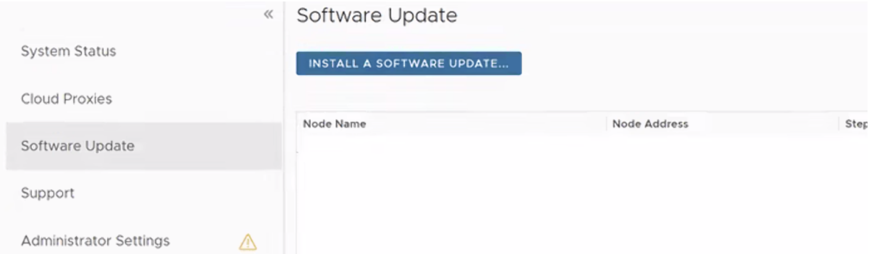

  • The Software Update page is empty under VCF Operations Admin page:
VCF Operations 9.x
The directory /usr/lib/vmware-casa-b2b/casa-b2b remains orphaned on the appliance after a previous failed upgrade, a failed Aria Operations Pre-Upgrade Readiness Assessment Tool (APUAT) run, or incomplete cleanup logic in the PAK manager. The presence of this directory causes the subsequent upgrade process to follow an incorrect code path, resulting in the LCMVROPSYSTEM25008 failure.
