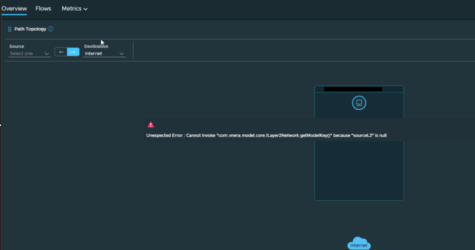

When performing data collection from an NSX-T data source in VCF Operations for Networks, you observe the following symptoms:
  • Logical ports in NSX data collection fail to populate or show up in the interface.
  • The VM-VM path topology fails to render correctly with "Unexpected Error: Cannot invoke "com.vnera.model.core.Layer2Network.getModelKey()" because "l2l" is null."
  • The collector logs (latest.log) contain the following error snippet:
    [YYYY-MM-DDTHH:MM:SSZ] ERROR common.utils.CommonUtils ,<datasource_name>_Config_OpMgr-1 logException:2680 Error in obtaining LogicalPortOperationalStatus for manager https://<datasource_name>:443
    java.util.ConcurrentModificationException: null
            at java.util.ArrayList.forEach(ArrayList.java:1513) _[_:_]
            at com.vnera.dataproviders.core.impl.vmware.nsxt.tasks.datafetchers.NSXTLogicalPortOperationalStatusFetcher.lambda_pushPayload_2(NSXTLogicalPortOperationalStatusFetcher.java:55) _[dataproviders-0.001-SNAPSHOT.jar:_]
NOTE:  VCF Operations for Networks was formerly named Aria Operations for Networks (AON), and prior to that was named vRealize Network Insight (vRNI).
  • VCF Operations for Networks
  • VMware NSX
The issue is caused by the enableNSXTPolicyAPI feature flag being set to false at the platform or collector level. This prevents the system from correctly utilizing the NSX-T Policy API to resolve Layer 2 network model keys during topology queries
