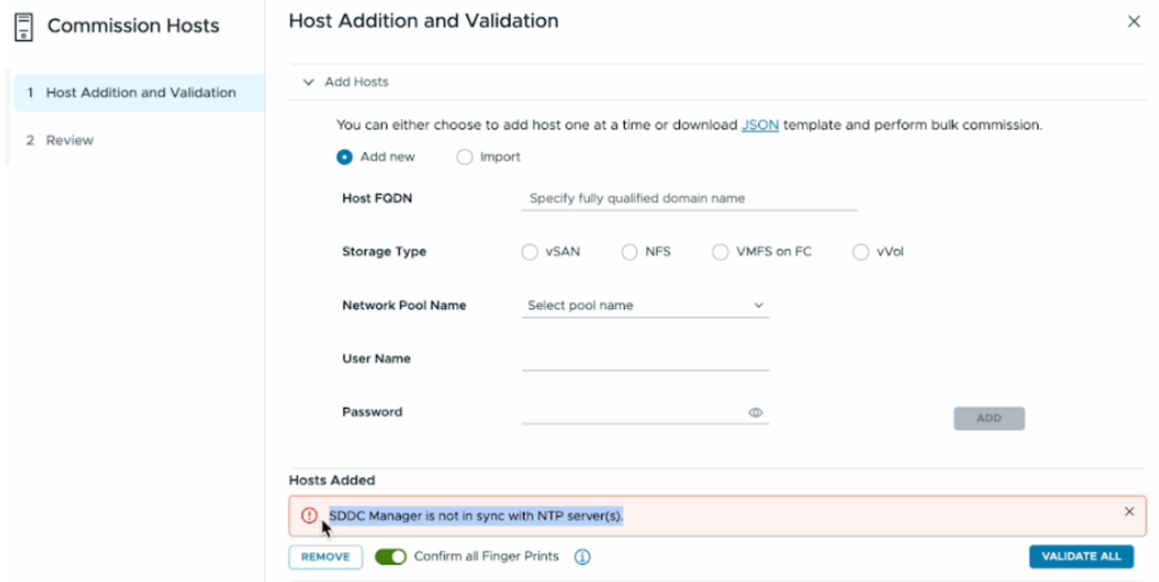

Commission Hosts task on SDDC Manager fails with error "SDDC Manager is not in sync with NTP server"
Article ID: 435519
VMware SDDC Manager / VCF Installer
  • On the SDDC Manager, commissioning hosts fails at Host Addition and Validation task with error "SDDC Manager is not in sync with NTP server".
