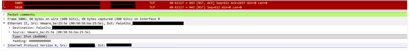

  • Packet capture shows lot of packet retransmits and connection closure with Reset flag.
Low network throughput and intermittent connectivity between the source and destination environments, specifically over the SSTP VPN tunnel, causing TCP resets and SSL handshake failures.
  1. Ensure all configuration parameters in the Converter agent, worker, and server XML files are at default settings.
  2. Work with network team to verify and improve the throughput of the SSTP VPN tunnel.
