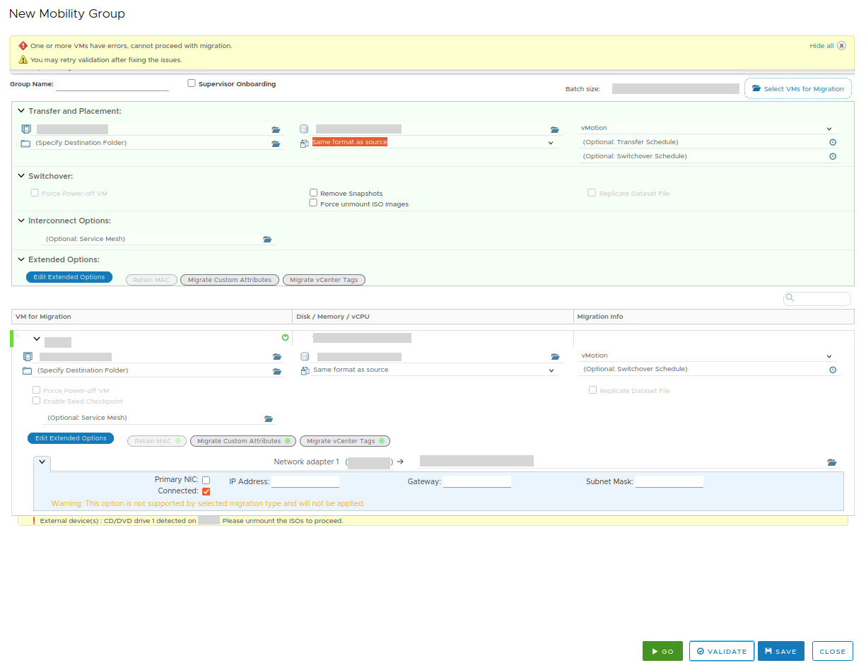

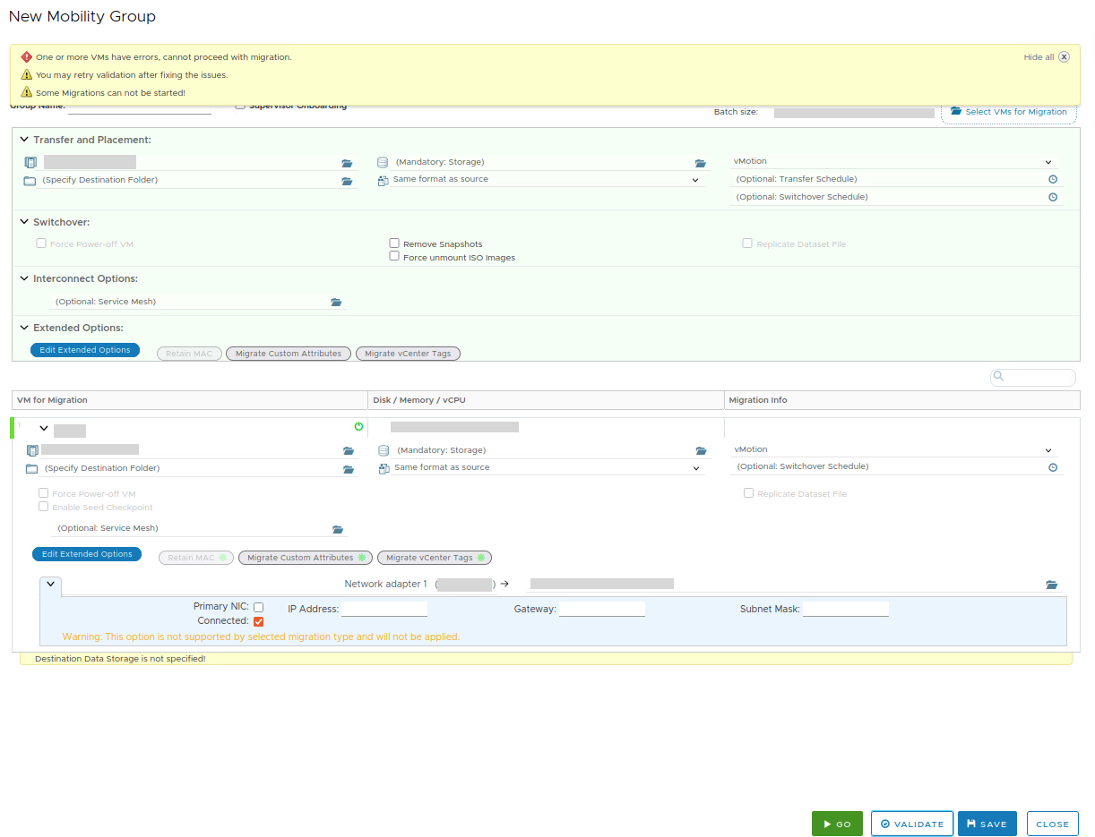

  • In the example below, the first attempt displays the error "Destination Data Storage is not specified!", while the second attempt displays the error "External device(s): CD/DVD drive 1 detected on <VM_name>. Please unmount the ISOs to proceed."
    First attempt:
    One or more VMs have errors, cannot proceed with migration.
    You may retry validation after fixing the issues.
    Some Migrations can not be started!
    Second attempt:

The first error is output when mandatory fields are not specified, in accordance with the behavior described in KB#415617. Unless this initial validation is passed, the subsequent detailed validations will not be executed.
Please continue to resolve the reported issues and re-run the validation until all validation errors are cleared.
