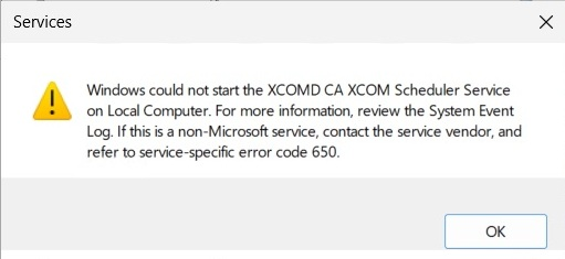

Trying to install XCOM for Windows 12.0 on Windows server 2025, but during the installation the process stops and crashes.
An XCOM service was created but fails to start with message:
Windows could not start the XCOMD CA XCOM Scheduler service
on Local Computer. For more information review the System Event
Log. If this is a non-Microsoft service, contact the service vendor, and refer
to service-specific error code 650.
