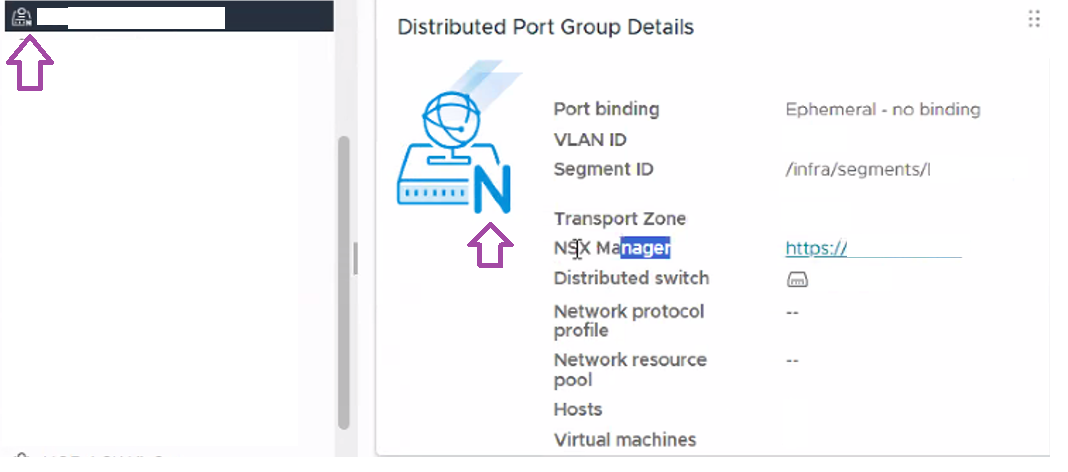

    1. Log into vCenter and select the Networking icon view
    2. For each vDS (Virtual Distributed Switch), examine the dvPGs (Distributed Virtual Port Groups) below the switch.
    3. Any of the dvPGs managed by NSX will have a small letter "N" attached to the icon, as in the screen shot below
    4. Log into the VCF Operations for Networks and select Settings --> Accounts and Data Sources
    5. Add the NSX Manager as a data source and configure IPFIX.
      • This ensures flow data for any workload attached to an NSX-managed dvPG is sent from the ESXi hosts that are attached to the vDS, to the VCF Operations for Networks Collector.
    6. Add the vCenter as a data source and configure IPFIX for the dvPGs that are strictly not managed by NSX.
      • This ensures flow data for any workload attached to a dvPG that is not managed by NSX, is sent from the ESXi hosts that are attached to the vDS, to the VCF Operations for Networks Collector.
