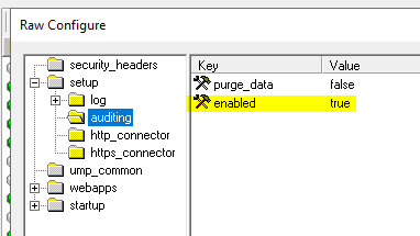

    • Save of changed groups failed if wasp auditing is enabled: 500 errors are found on browser's DevTools:
  • Key Observations:
    • The issue is NOT present in 23.4 CU5 or earlier. The issue begins occurring immediately after upgrading to 23.4 CU6 (or higher).
    • The issue only occurs when auditing key in wasp/setup/auditing is set to true.
    • When auditing is set to false, the issue does not occur.
    • The error is specific to Linux-hosted OC
