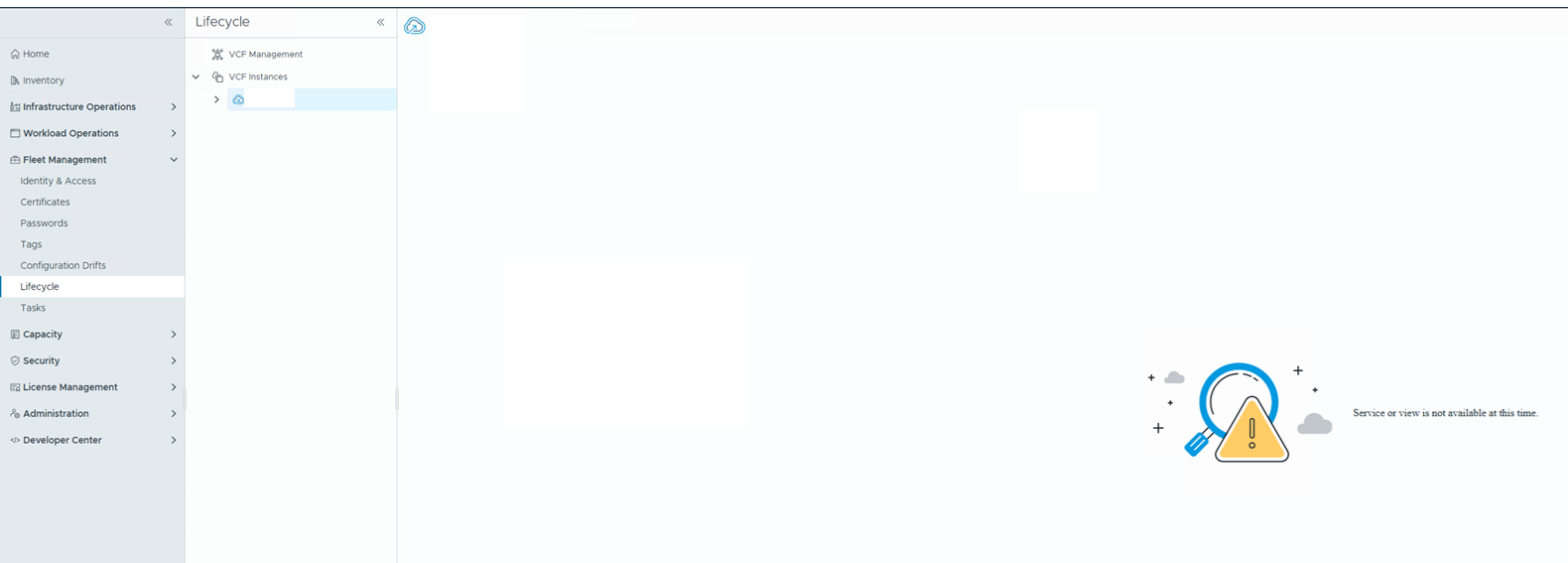

  • While navigating to VCF Operations → Fleet Management → Lifecycle → VCF Instances → VCF instance, UI consistently displays the error:
    “Service or view is not available at this time.”
