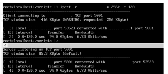

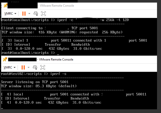

  • Despite having 25Gbps NICs, internal iperf3 tests between VMs on the same host (using the virtual switch backplane) yielded results as low as 8-13Gbps, compared to the expected 30-40Gbps.
Example:
One host achieves ~30.8 Gbps (Expected), while another (the "bad host") caps at ~8.59 Gbps.
Bidirectional tests show uneven results (e.g., 13 Gbps one way, 6 Gbps the other).

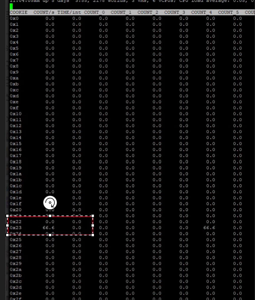

  •  esxtop reveals high interrupt values on the problematic host as show below:
VMware ESXI
The root cause is a defective hardware component (likely a faulty CPU or Motherboard/VRM) generating excessive interrupts. This "hardware noise" prevents the CPU from efficiently processing network packets, leading to the massive drop in iperf3 performance even when the traffic is purely internal to the ESXi host.

  • Use the esxtop utility to compare a "Good" host against the "Bad" host.
    1. Run esxtop from the ESXi CLI.
    2. Press 'i' to view interrupt statistics.
    3. Monitor the "I" (Interrupts) column while the iperf3 test is running.
Good Host: Low to zero unexpected interrupts during high-load traffic.
Bad Host: Consistent high interrupt spikes, indicating the CPU is being overwhelmed by hardware-level requests.
