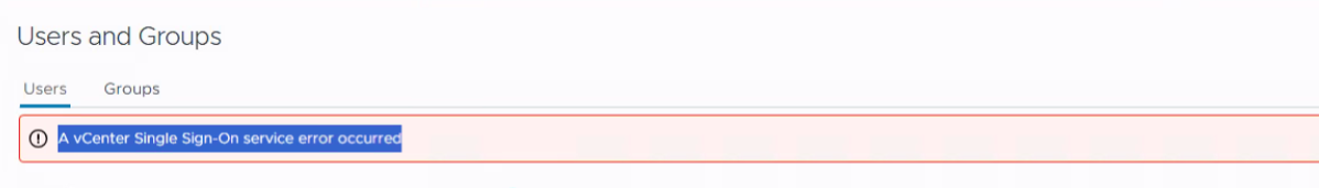

vCenter Server (VC) displays "A vCenter Single Sign-On Service error occurred" when accessing the Users and Groups UI when the ADFS domain is selected.
Consequently, administrators are unable to query, search, or enumerate user and group objects from the Active Directory domain within the vSphere Client interface.
However, existing user logins to the vCenter Server continue to authenticate and function successfully.

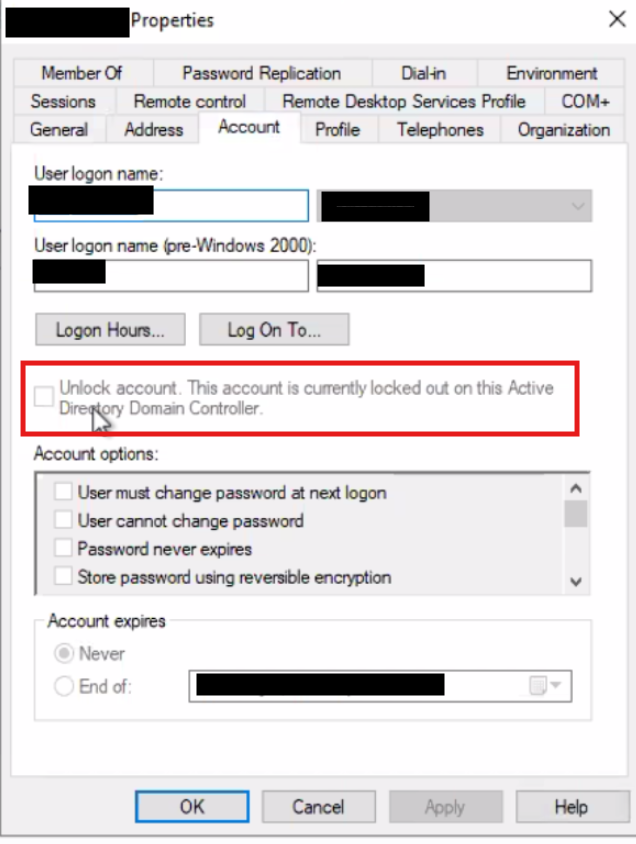

However, the vSphere Client UI relies exclusively on the configured LDAP bind parameters (Base DN, Username, Password) specified during the ADFS federation setup to populate the Users and Groups tab.
When this specific bind account becomes locked, the LDAP query fails, triggering the SSO service error.
Evidence of the locked account is present in the provided screenshot, which indicates the "Unlock account" option is grayed out.
The account is currently locked out on the following Active Directory Domain Controller.
  • Access the Active Directory environment and unlock the specific service account utilized for the LDAP bind within the vCenter ADFS configuration.
  • If the service account password requires a reset, update the credentials within vCenter.
    • Navigate to Administration > Single Sign-On > Configuration > Identity Provider.
    • Edit the ADFS Identity Provider configuration.
    • Update the password in the Users and Groups panel for the Active Directory over LDAP connection.
