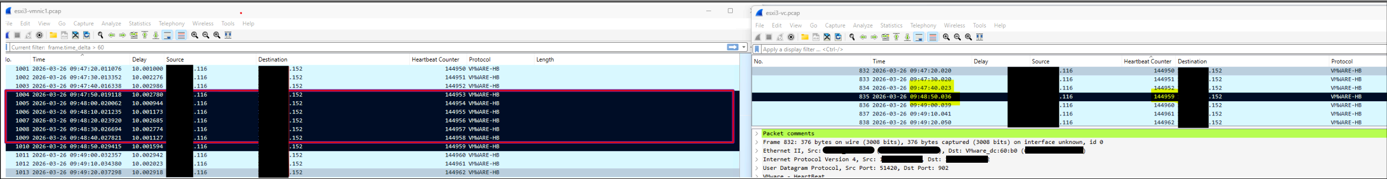

Perform packet capture on the affected host's management VMKernel interface or corresponding uplink (VMNIC).
Refer Performing Rolling Packet Captures on ESXi
The resulting capture can be analyzed in Wireshark with the help of the "Heartbeat Counter" column:
The capture on the left shows heartbeat packets being sent to vCSA but the Heartbeat Counter column in the second capture shows a jump from 144952 to 144959 indicating missing heartbeats.
