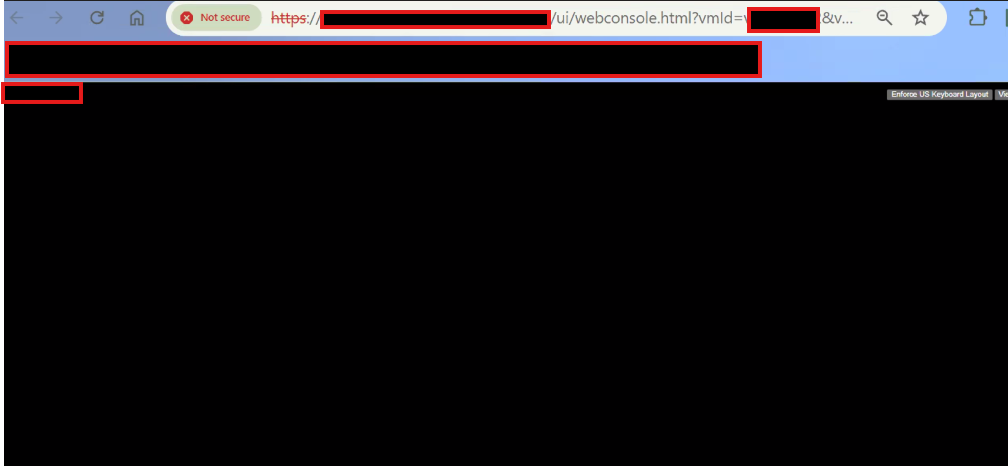

  • Post deploying Ubuntu based Guest OS using template, halfway through boot process we will see the blank / black screen in the Guest OS as -
  • While the networking and storage configuration is intact, the Guest OS is just stuck at blank / black screen after VM powering on
