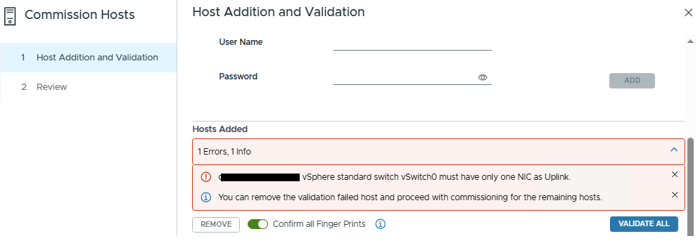

Host commissioning fails with "vSphere standard switch vSwitch0 must have only one NIC as Uplink"
Article ID: 434936
VMware SDDC Manager / VCF Installer
  • Host commissioning from SDDC Manager or vCenter Server fails with the following error:
"vSphere standard switch vSwitch0 must have only one NIC as an uplink."
  • In the var/log/vmware/vcf/operationmanager/operationmanager.log on SDDC Manager, you will find entries similar to:
