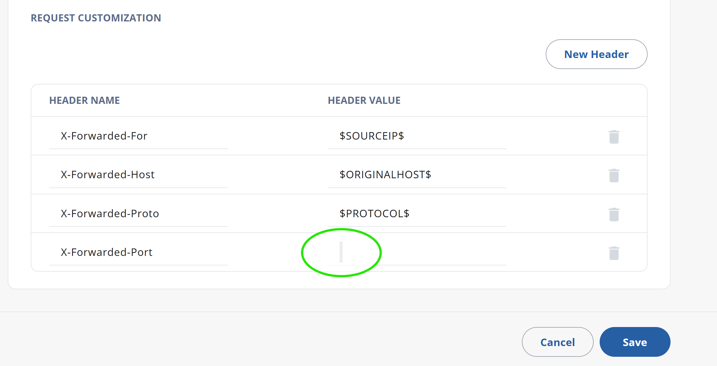

A web-application is failing to work via ZTNA because the redirect responses are pointing to the application with the client port rather than the server port.
For example the server returns:
Location: example.luminatesec.com:45161
Instead of:
ZTNA
The application access via ZTNA is taking the information from the "X-Forwarded-Port" and uses it in the redirect url which is breaking the application.
Here is a sample http request output to a test Python server, via ZTNA, showing the headers added by ZTNA to the http request:

    X-Forwarded-Host: python-web-server-app.example.luminatesec.com\r\n
    X-Forwarded-Port: 45161\r\n
    X-Forwarded-Proto: HTTPS\r\n
    Connection: close\r\n
Because the header is added by ZTNA by default and is not available for deletion in the ZTNA application UI (Web application -> advanced -> request customisation fields) we need to add a custom header named "X-Forwarded-Port" with a white space (" " without the double quote in the value field) to avoid those redirect problems, as illustrated below (the space value is selected with the mouste to make it visible).
