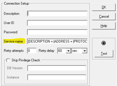

To resolve this behavior and ensure checkpoints and metrics are correctly collected under the proper device name, modify the connection configuration to use a specific server connection string instead of a service name.
1. Open the oracle probe configuration.
2. Locate the connection profile for the affected database.
3. Update the Service name field from a Service Name to a full TNS description string
Example:
(DESCRIPTION = (ADDRESS = (PROTOCOL = TCP)(HOST = [primary_host])(PORT = 1521))(CONNECT_DATA = (SERVER = DEDICATED)(SERVICE_NAME = [service_name])))
4. Restart the oracle probe to apply changes.
