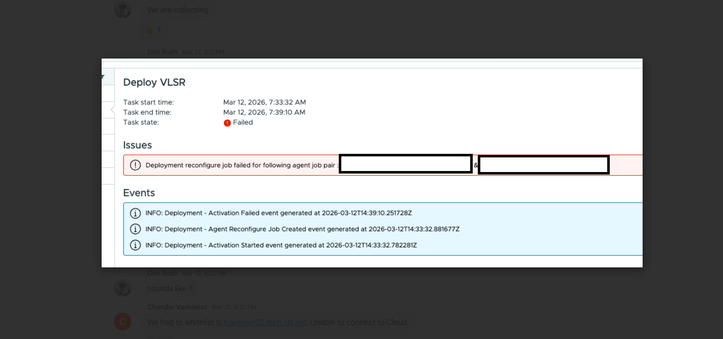

Deployment reconfigure job failed for following agent job pair.

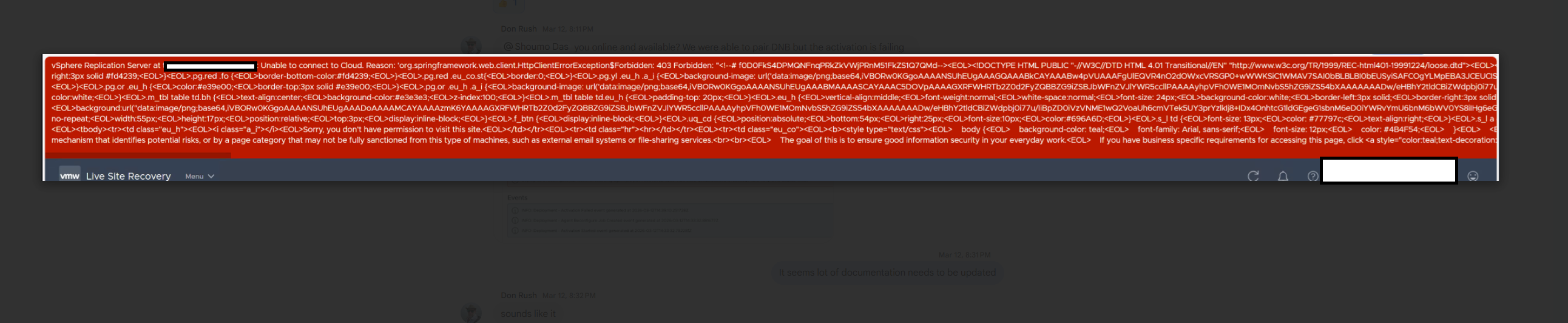

While connecting to VMware Cloud recovery the configuration fails with the below error:
The Live Site Recovery dashboard displays the below error:
VMware Live Site Recovery 9.0.2.2
The issue is caused due to blocking of the vSphere replication Appliance IP/FQDN by the Firewall in the environment.
For a version 9.0.2 though the SRM IP/FQDN was whitelisted the VR IP was complaining for the connectivity issue with the error posted in the above screenshot.
The fix is to whitelist the vSphere Replication appliance URL/IP in the Firewall configuration.
