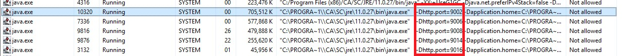

Most xFlow installations will have around 5 processes running.  These represent the microservices that comprise xFlow functionality.  When viewed from Task Manager, sorting by Command Line and Process Name "Java.exe", you will find a list of entries such as this:
The above shows five such entries, with their http port circled for illustration.
Of concern in particular is the incident microservice, which usually operates on http port 9002 or https port 9444 and needs to be running to allow access to xFlow via web UI.  Port allocations are often arbitrary, but default port values are often used.
