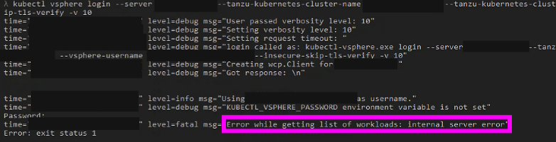

Login to the Supervisor Cluster or VKS Cluster using kubectl vsphere login with a domain account failed and returned an "Internal server error".

Login to the Supervisor Cluster or VKS Cluster using a domain account fails intermittently and returns an "Internal server error".
vSphere with Tanzu 8.0
- The issue occurs because communication between the backend vCenter Server and the Domain Controller takes longer than one minute while validating the user credentials.
- At the same time, the kubectl vsphere login command has a default timeout of 60 seconds, which causes the login request to fail before authentication completes.
wcp-authproxy
- The wcp-authproxy log also confirms that the client connection was closed after 60 seconds:
stderr F INFO:server:[140219366038240] "127.0.0.1" - - [25/Mar/2026:01:36:17 +0000] "GET /wcp/workloads HTTP/1.0" 200 76 "-" "kube-plugin-vsphere bld 24795027 - cln 15520604" "<USERNAME>"
stderr F DEBUG:server:[140219366234464] Request: b'POST' b'/wcp/login' 127.0.0.1
stderr F WARNING:server:[140219366234464] Connection lost. <------------ After 1 min
stderr F twisted.internet.error.ConnectionDone: Connection was closed cleanly.
