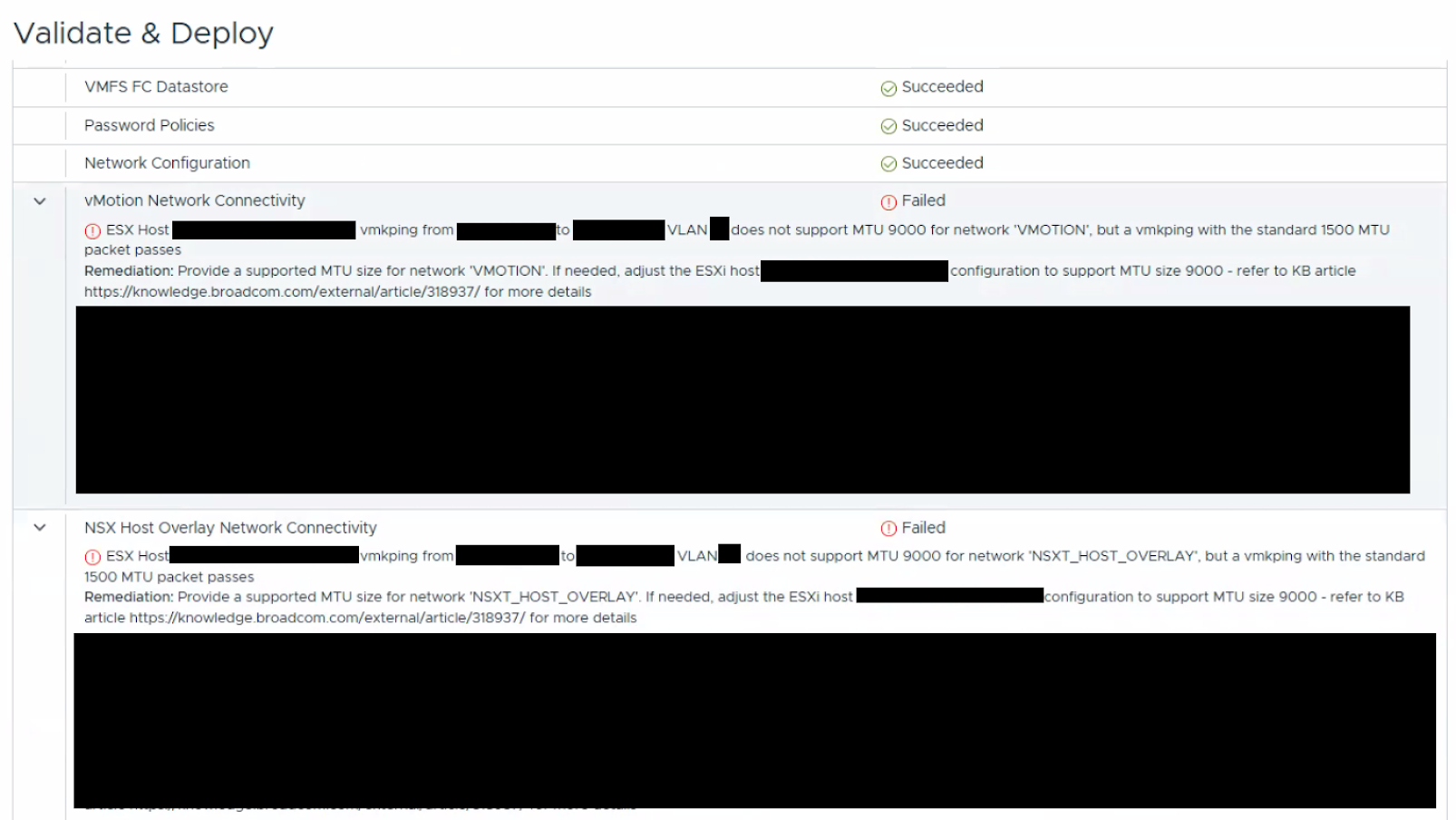

  • During a VMware Cloud Foundation (VCF) 9.x deployment, the installer validation and deployment workflow fails with below error:
    vMotion Network Connectivity
    ESX host vmkping from VLAN #### does not support MTU 9000 for network "VMOTION', but a vmkping with the standard 1500 MTU packet passes.
    Remediation: Provide a supported MTU size for network 'VMOTION". If needed, adjust the ESXi host
    https://knowledge.broadcom.com/external/article/318937/ for more details
    NSX Host Overlay Network Connectivity
    ESX Host '<ESXI_HOST_FQDN' -> '<IP_ADDRESS>  VLAN '####' with MTU 9000 fail to vmkping. Possible no network connection or not reachable
    Remediation: Ensure that ESX Host <ESXI_HOST_FQDN> is responsive
  • The installer errors out while checking network connectivity because it detects failure in vmkping using jumbo frames for the vMotion VMkernel adapter and NSX TEPs between ESXi hosts.
  • Validated that both the vmk and vSwitch are set to 9000 MTU.
  • During the "Validate Network" phase of a Workload Domain deployment in SDDC Manager, the task may fail with the following error:
    YYYY-MM-DDT HH:MM:SS ESX Host '' vmkping from '##.###.##.##' to '##.###.##.##' VLAN '' doesn't support MTU 9000 for network 'VMOTION' but smaller 1500 MTU packet passes
