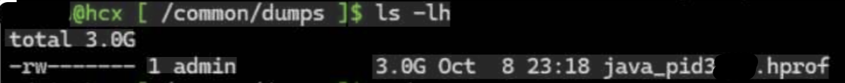

An HCX Manager appliance may experience high disk space utilization within the /common partition.
There are large.hprof files residing in /common/dumps/
These files are generated when Java processes (such as app-engine) encounter critical memory exhaustion.
VMware HCX 4.10.x
The Java Virtual Machine (JVM) automatically generates a heap dump (.hprof) for diagnostic purposes during a service crash or OutOfMemoryError. These artifacts are not automatically purged and can consume significant storage over time.

  3. Navigate to the dumps directory: cd /common/dumps/
  4. Identify the files and their creation dates: ls -lh
