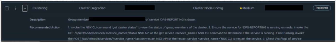

Users may encounter various alerts within the VMware NSX Manager UI indicating that critical services—such as IDPS-REPORTING, MONITORING, and HTTP—are in a "Down" or "Degraded" state. These alerts often appear under the Clustering or Node Configuration sections with a status of "Cluster Degraded."
Even if these alerts currently show as Resolved in the UI history, they may persist in the alert dashboard and require manual intervention to clear the visual warning and return the cluster health status to green.

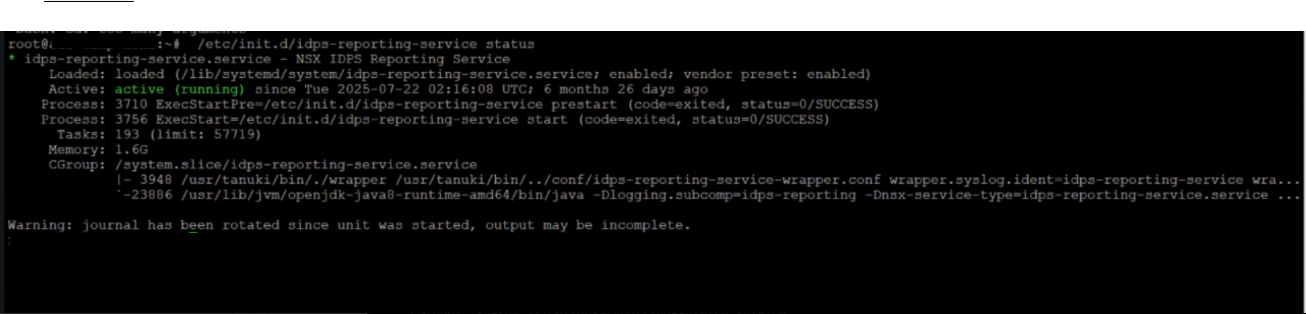

1. Verify Service Status via CLI
Log in to the NSX Manager node reporting the issue via SSH or console as root and check the status of the reported service. For example, fo the IDPS Reporting service, use:
/etc/init.d/idps-reporting-service status
Expected Result: The output should show Active: active (running).
