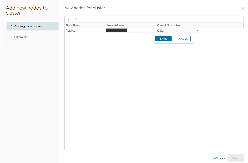

  • An error may be displayed when attempting to add a replica node that was previously part of the cluster to an existing Aria Operations cluster:
  • https://replica_node_IP_or_FQDN/admin is accessible.

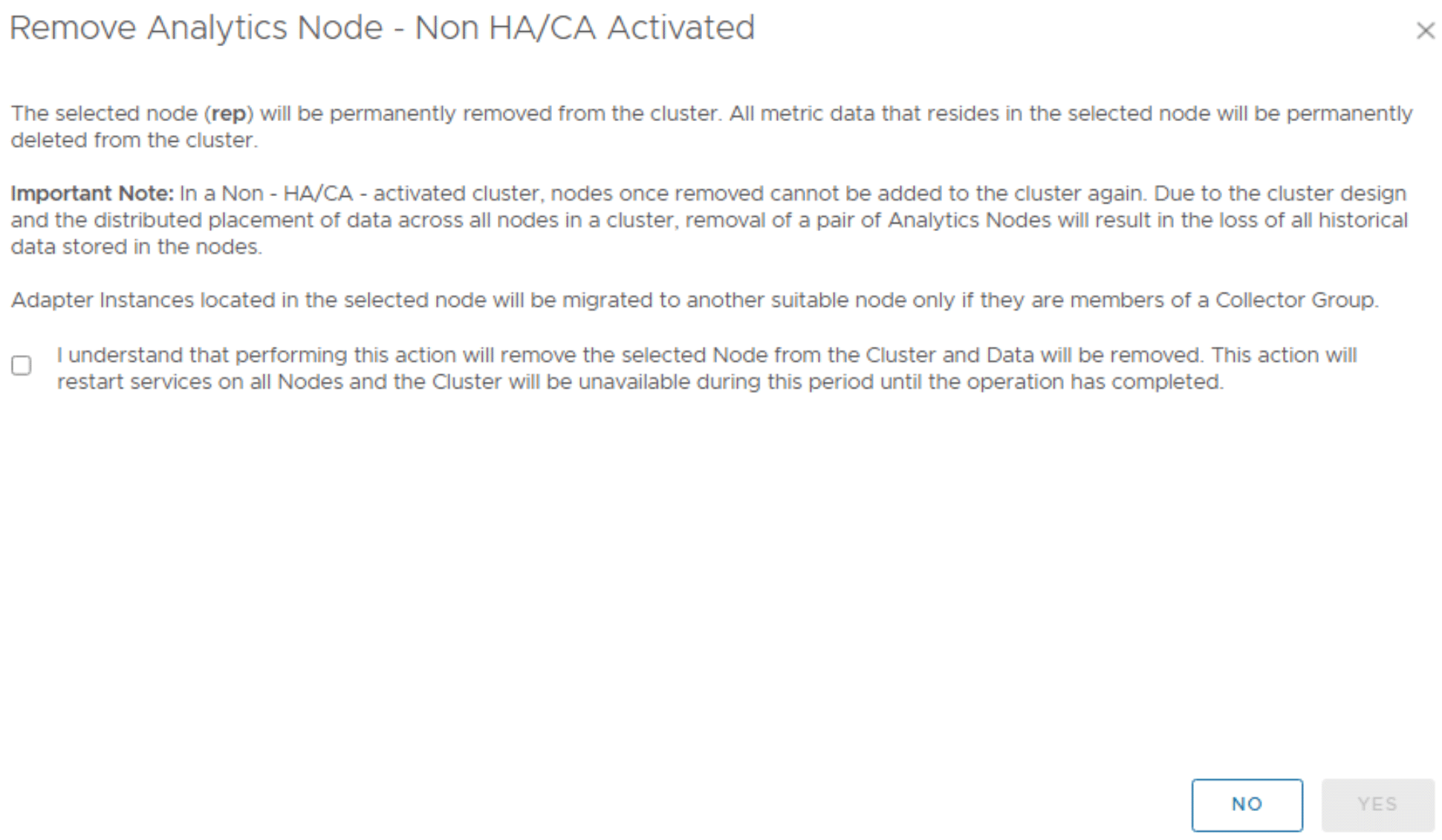

Once a node is removed from the cluster, it cannot be re-added to the same cluster.
This behavior is by design. A warning message is displayed during the node removal process indicating this limitation.
