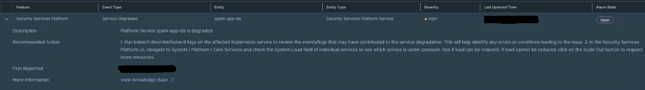

  • Alert observed: Platform Service spark-app-ids is degraded
Spark driver logs showing: Refrence article  https://knowledge.broadcom.com/external/article?articleNumber=384122
command output as per above kb > k -n nsxi-platform get pod spark-app-ids-driver -o jsonpath='{.metadata.ownerReferences[0].kind}'
 WARN task-starvation-timer TaskSchedulerImpl - Initial job has not accepted any resources; check your cluster UI to ensure that workers are registered and have sufficient resources

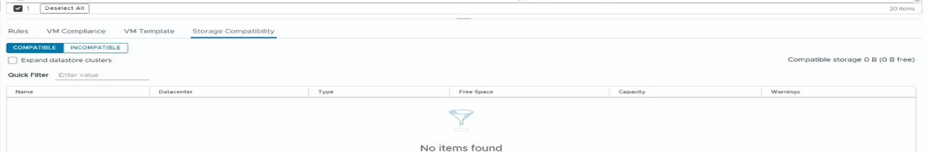

  • The storage policy associated with the PVC are not having  any available datastores.
  • The applied storage policy did not return any compatible storage
  • This may  led to storage provisioning failure
  • As a result, PVCs may remain unbound and pods will stay in Pending state
Ensure that storage policy used for  SSP shows  valid datastores. If in compatible datastore doesnt show any information please contact Broadcom support for further trouble shooting.  For example : below screenshot of storage policy doent have any data-stores in compatible list.
vCenter server >Policies and Profiles >VM Storage Polices> Used policy for SSP
