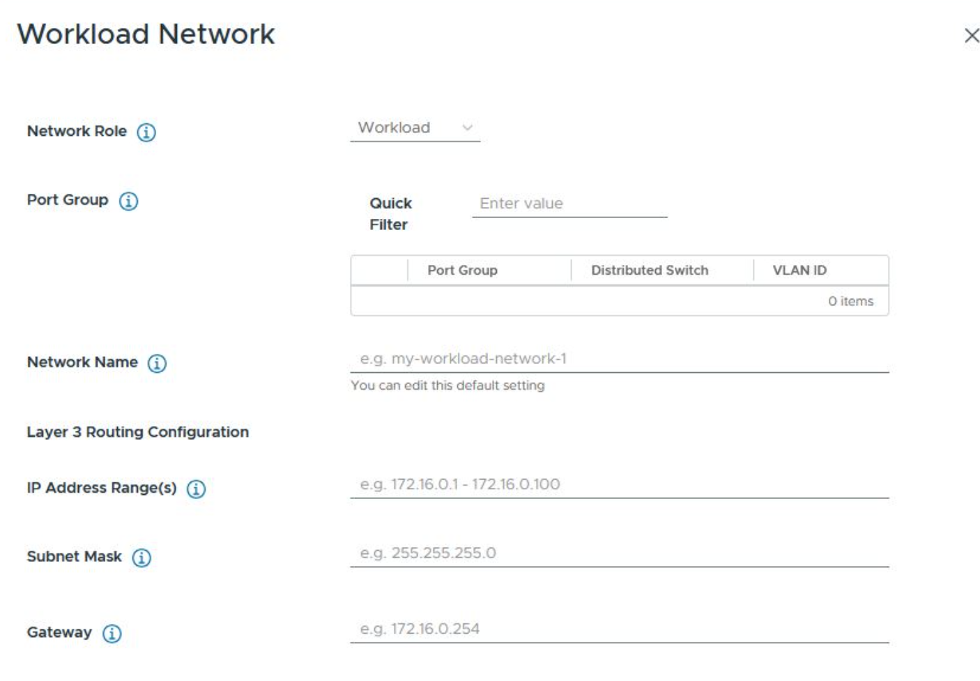

  • Portgroups do not populate when adding a workload network on a Supervisor configured with a Foundation Load Balancer (FLB).
  • Navigating to Supervisor > Configure > Network > Workload Network > ADD displays an empty table with no Port Groups listed.
