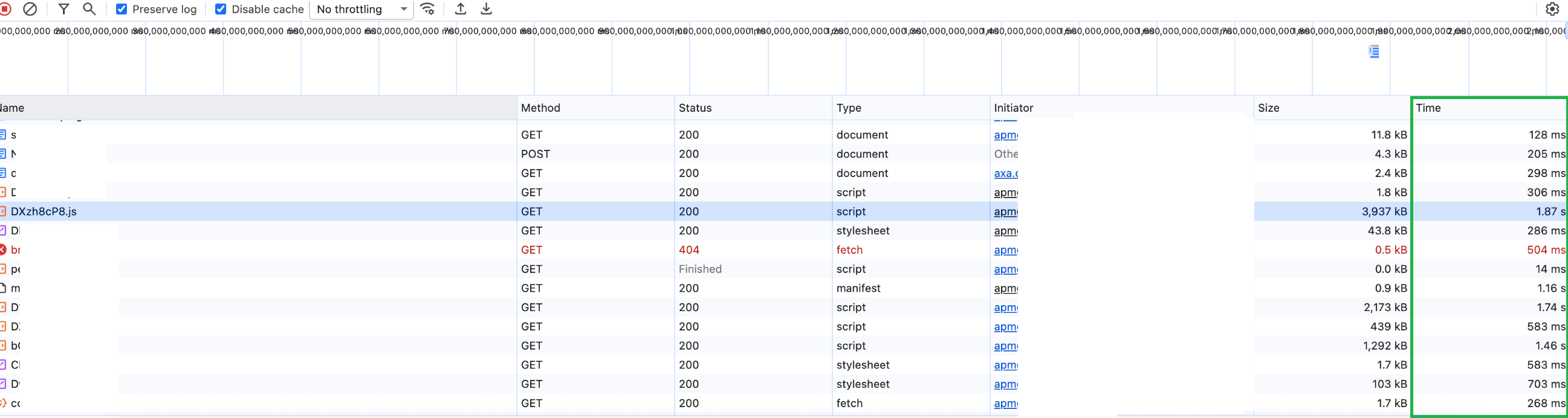

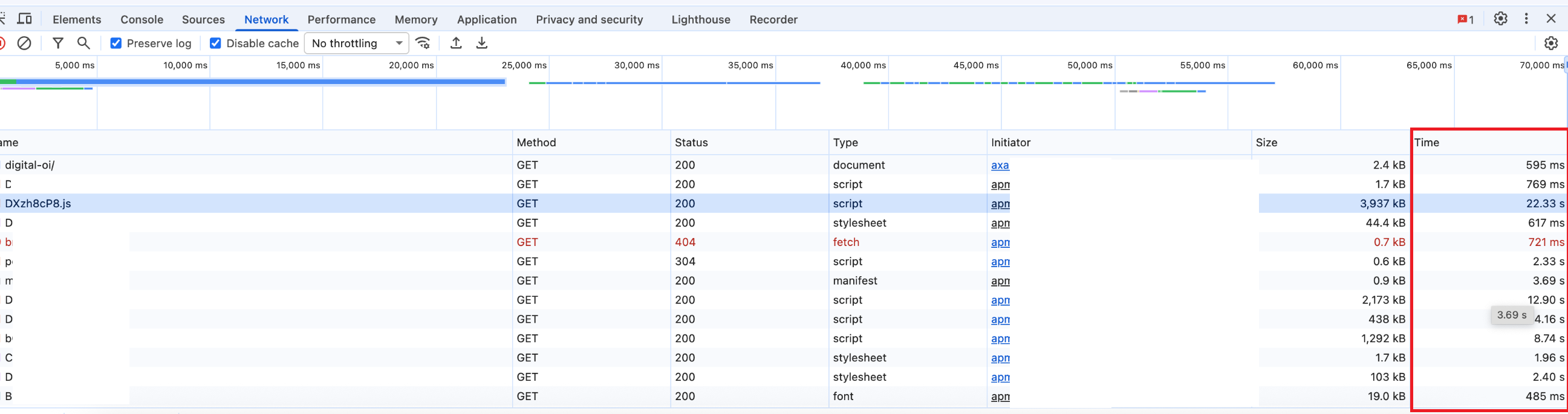

Here is an example illustrating an issue from problematic and not problematic user:
-User with delay issues during login, 22 seconds to download a file -
vs. working user, login took less than 2 seconds
In this case download speed is low possibly due to VPN or network routing. Check with your Network team
