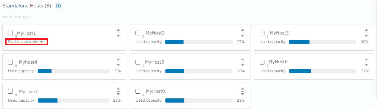

  • When managing a vSAN environment, you observe the following symptoms within the vSphere Client (vCenter):
    • In Cluster -> Configure -> vSAN -> Fault Domains, one specific host shows no claimed disk groups or is not contributing storage capacity.
    • Despite the missing storage, all vSAN objects appear as "Healthy" when viewed in Cluster -> Monitor -> vSAN -> Virtual Objects.
    • The affected host appears to be a member of the cluster and is not in Maintenance Mode.
