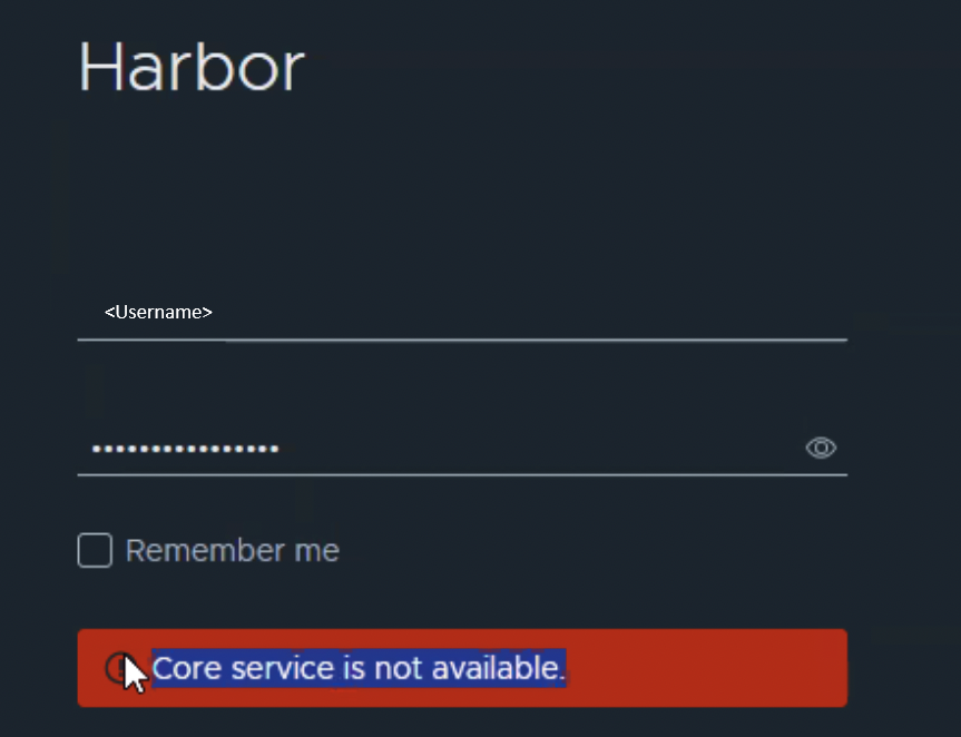

Error: "Core service is not available"

  • unable to access the CNF harbor, getting error message in GUI
  • Running kubectl logs -n <harbor-namespace> <harbor-pod> can show:
    • PANIC: could not write to file
    • No space left on device
