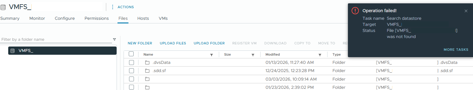

Search datastore failed - The datastore is not completely accessible

All VMs on one datastore are going unresponsive and when attempting to browse the datastore the following is reporting:
You will see the Host reporting the below error message:

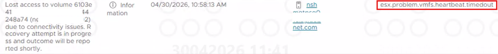

In vCenter the datastore shows as reporting:
Lost access to volume ########-########-####-############ (VMFS_###########) due to connectivity issues. Recovery attempt is in progress and outcome will be reported shortly.
In the vobd.log file the datastore reporting heartbeat loss
2026-04-27T04:15:52.513Z In(14) vobd[2097490]:  [vmfsCorrelator] us: [vob.vmfs.heartbeat.timedout] #########-#########-####-############# VMFS_##########
2026-04-27T03:23:01.482Z In(14) vobd[2097667]:  [vmfsCorrelator] 24835568598802us: [vob.vmfs.heartbeat.timedout] 6103####-6d####3a-7024-78######74 ne######16_##02
2026-04-27T03:23:01.482Z In(14) vobd[2097667]:  [vmfsCorrelator] 24835524246646us: [es#.problem.vmfs.heartbeat.timedout] 6103####-6d####3a-7024-78######74 ne######16_##02
