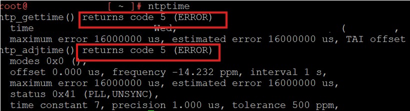

  • ntptime command returns error "ntp_gettime() returns code 5 (ERROR)":
  • ntpdate <NTP_IP> command corrects the time briefly however, the time drifts away repeatedly.
