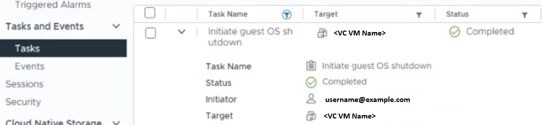

  • vCenter Server is getting powered off by a service account.
  • Virtual Machine -> Monitor -> Tasks shows the "Initiate Guest OS Shutdown" task with the user account which initiated the task.
  • vCenter logs shows the task details as below:

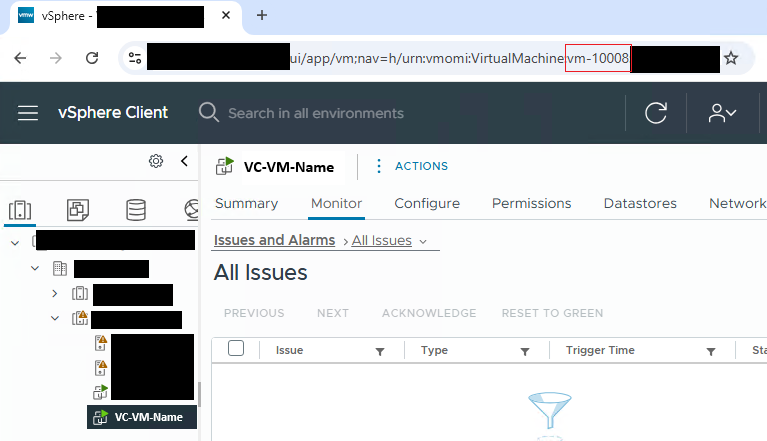

  1. Login to vSphere Client.
  2. Select the vCenter Server VM from the Inventory and note down the MoID of the VC VM from the browser URL. In the sample screenshot pasted below, the MoID of the VM is "vm-10008".
