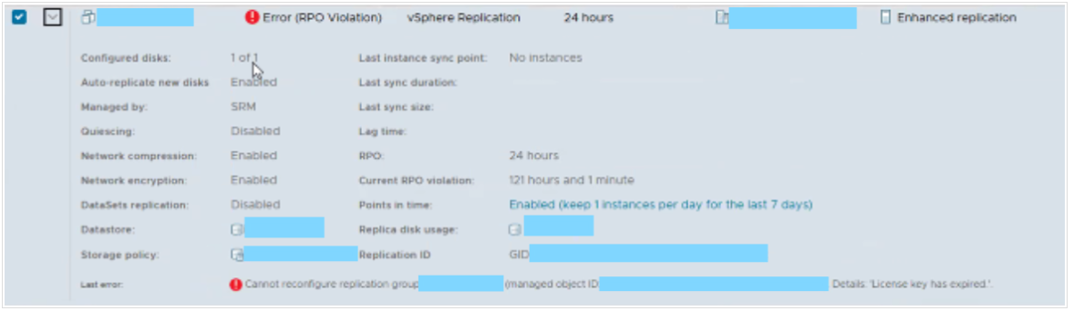

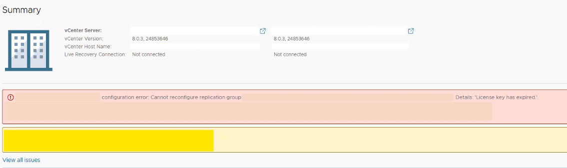

Replication Error "Cannot reconfigure replication group 'abcd' (managed object ID: "GID-b173###-###-###-###-8017eBc###'). Details: "License key has expired.'.

Virtual machines cannot replicate and have an Error related to License key.
