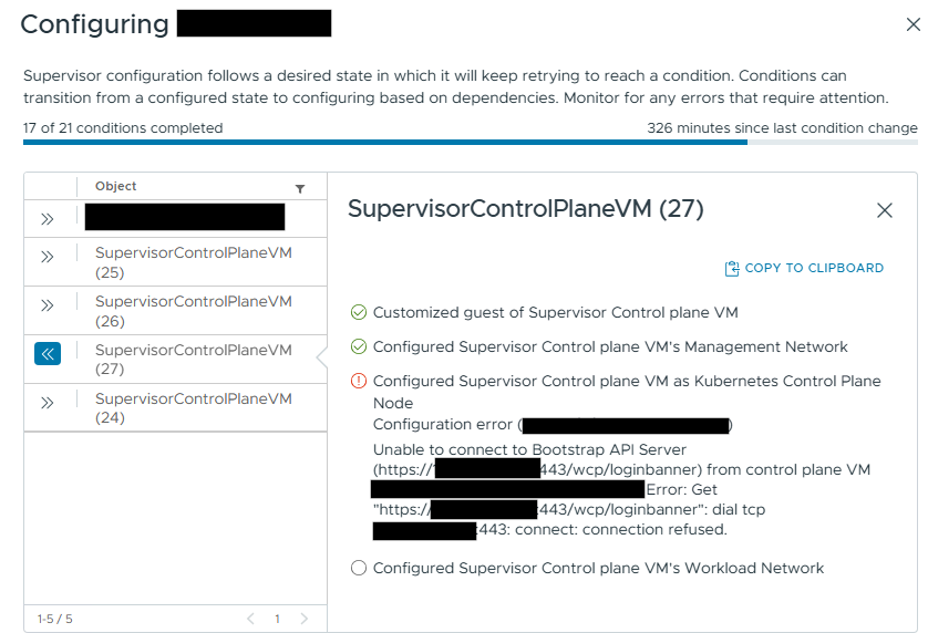

  • The Supervisor VM upgrade is failing with error "Unable to connect to Bootstrap API server", while the IP in the error message is for existing Supervisor VMs:
  • The error indicates the new Supervisor VM created during the upgrade is unable to connect to existing Supervisor VM over port 443 via the management network.
  • "curl -kv https://<Destination-Supervisor-VM>" shows Connection Refused.
