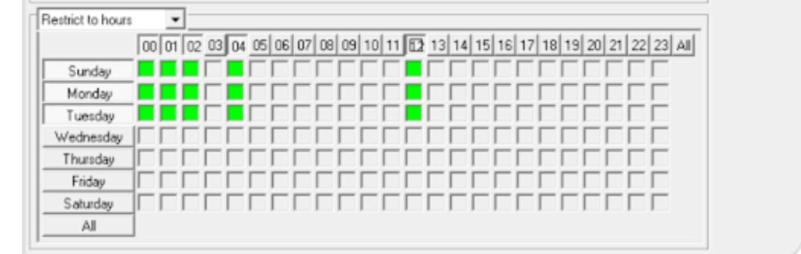

Within the processes probe, it is possible to create a schedule for profiles.
When selecting any combination of hours/days, all the hours are selected for any day that is selected, or vice versa.
Is it possible to set different hours for different days?  For example, running during certain hours on weekdays, but different hours on the weekend?
DX UIM - Any Version
processes probe - 3.20 and higher
It is not currently possible to select different hours for different days.
To achieve this, create two different schedules (e.g. one "weekend" schedule and one "weekday" schedule) and two profiles pointing to the same process.
This will result in the "weekend" QoS data being considered as a separate object than the "weekday" QoS meaning you will have to add both QoS's to the same chart in order to view the continuous flow of data, but otherwise should achieve the desired result.
