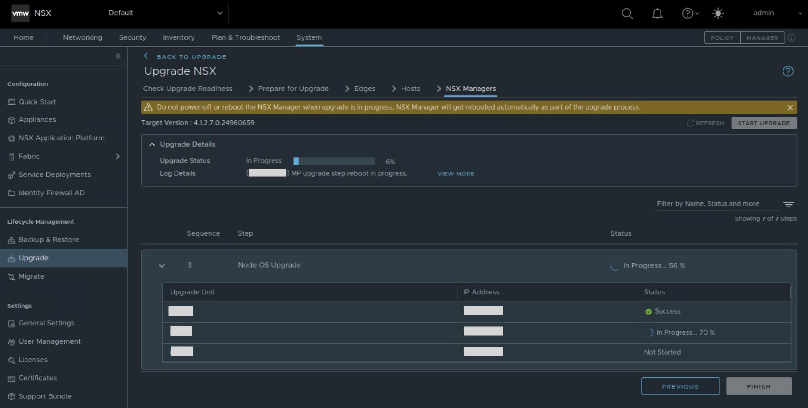

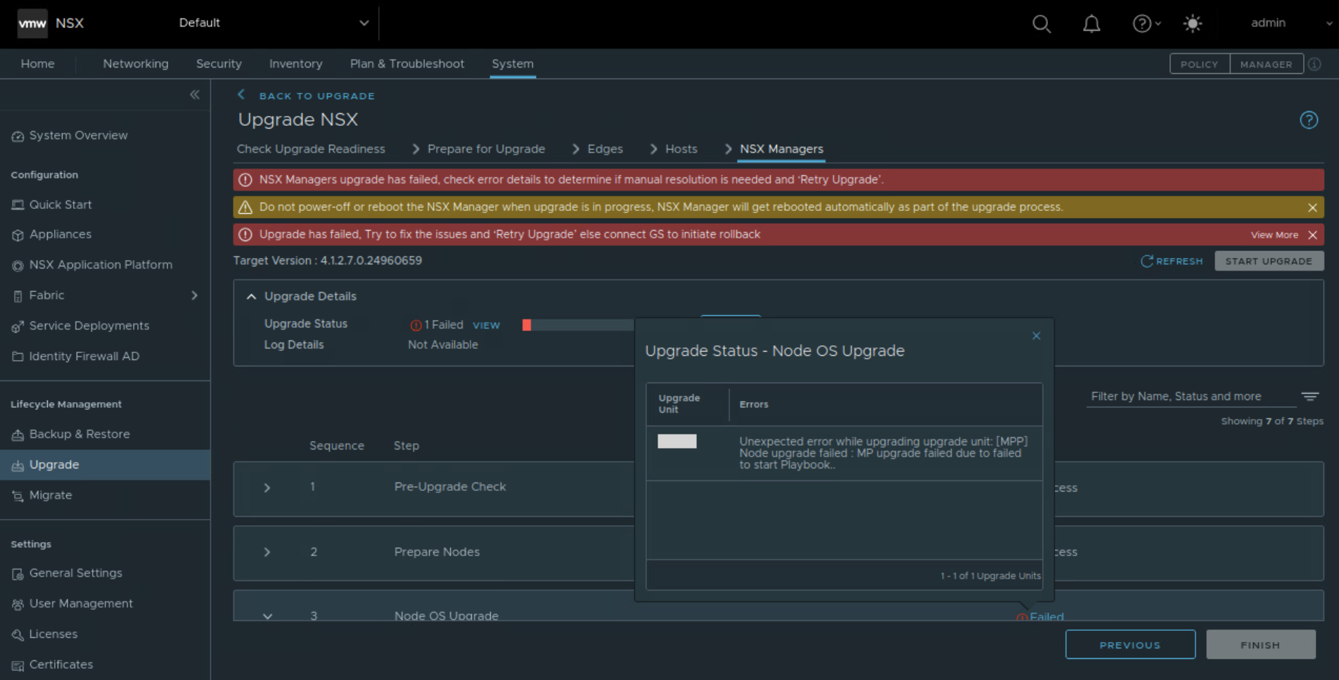

  • NSX Manager upgrade fails with the following message. Retrying the upgrade fails with the same message.
    [MPP] Node upgrade failed : org.springframework.web.client.HttpServerErrorException$InternalServerError: 500 Internal Server Error: "{"error_code": 36580, "error_message": "Error proxying request to: <uuid>.", "module_name": "node-services"}".
    or
    Unexpected error while upgrading upgrade unit: [MPP] Node upgrade failed : MP upgrade failed due to failed to start Playbook..
  • In many cases, the above error occurs after the reboot step remains In Progress at 70% for several hours or more.
  • The following error is logged in /var/log/upgrade-coordinator/upgrade-coordinator.log on the orchestrator node.
    <timestamp>  INFO http-nio-127.0.0.1-7442-exec-9 UpgradeCoordinatorFacadeImpl <pid> SYSTEM [nsx@6876 comp="nsx-manager" level="INFO" subcomp="upgrade-coordinator"] Component: MP, status: FAILED, % complete: 24.0, details: [MPP] Node upgrade failed : org.springframework.web.client.HttpServerErrorException$InternalServerError: 500 Internal Server Error: "{"error_code": 36580, "error_message": "Error proxying request to: <uuid>.", "module_name": "node-services"}"., canSkip: false
