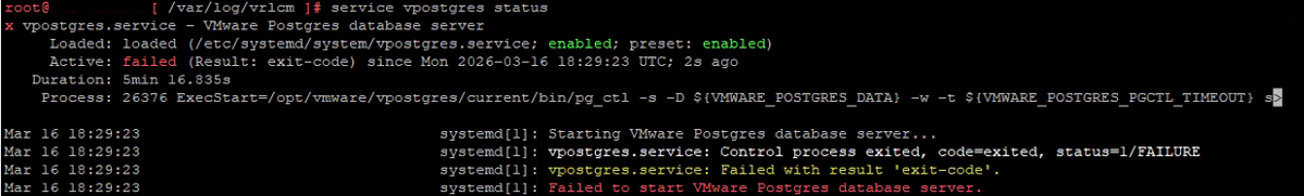

  • Aria Suite Lifecycle Manager patch upgrade fails and the Postgres service is not starting properly afterwards
  • The /var/log/vrlcm/os-package-update.log shows the following error
error: unpacking of archive failed on file /opt/vmware/vpostgres/current; 69b84901 cpio: File from package already exists as a directory in system
error: VMware-Postgres-14.20.0-25175663.x86_64: install failed
  • The Aria Suite Lifecycle Manager admin UI is stuck on starting services

  • The /var/log/vrlcm/vmware_vrlcm.log shows similar entries
ERROR LCM_FQDN — [ main] o.h.e.j.s.SqlExceptionHelper [logExceptions] : Connection to localhost:5432 refused. Check that the hostname and port are correct and that the postmaster is accepting TCP/IP connections.
ERROR LCM_FQDN — [ main] j.LocalContainerEntityManagerFactoryBean [buildNativeEntityManagerFactory] : Failed to initialize JPA EntityManagerFactory: [PersistenceUnit: default] Unable to build Hibernate SessionFactory; nested exception is org.hibernate.exception.JDBCConnectionException: Unable to open JDBC Connection for DDL execution
