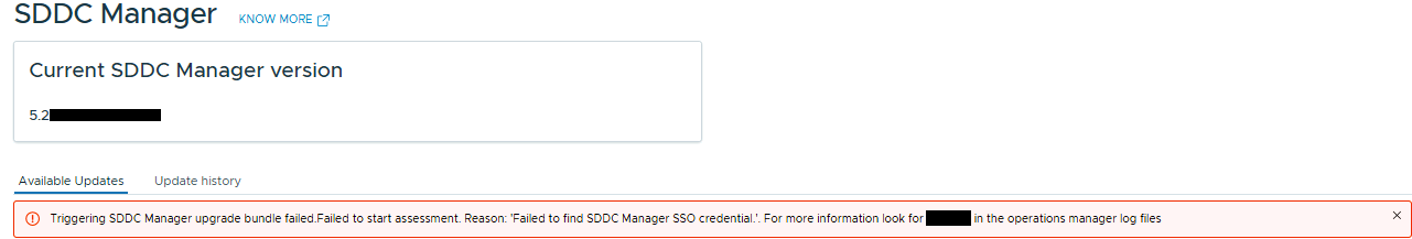

  • When you attempt to run prechecks or initiate an upgrade within SDDC Manager, the process fails immediately. A red banner appears in the interface stating:
    Triggering SDDC Manager upgrade bundle failed. Failed to start assessment. Reason: 'Failed to find SDDC Manager SSO credential.'. For more information look for ##### in the operations manager log files
