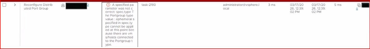

- Modifying distributed portgroup in vCenter from static port binding to ephemeral gives below error
"A specified parameter was not correct: spec.type The Portgroup type value : ephemeral specified in spec.type cannot be applied at this point because there are vms/hosts connected to the Portgroup type."
- Below log entries are observed in var/log/vpxd.log
2026-03-17T07:09:02.779Z info vpxd[958426] [Originator@6876 sub=vpxLro opID=mkff1fw7-932031-auto-jz5s-h5:70108471-d9] [VpxLRO] -- FINISH task-2193
2026-03-17T07:09:02.779Z error vpxd[958426] [Originator@6876 sub=Default opID=mkff1fw7-932031-auto-jz5s-h5:70108471-d9] [VpxLRO] -- ERROR task-2193 -- 524ed843-16f2-f9ca-fde7-2288737c46bb(52075a5c-8045-eb9f-bfd3-39f6597e79a4) -- dvportgroup-10xx -- vim.dvs.DistributedVirtualPortgroup.reconfigure: :vmodl.fault.InvalidArgument
