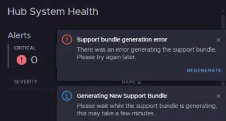

Attempting to generate a new support bundle through the Tanzu Hub UI results in "Support bundle generation error - There was an error generating the support bundle. Please try again later."
