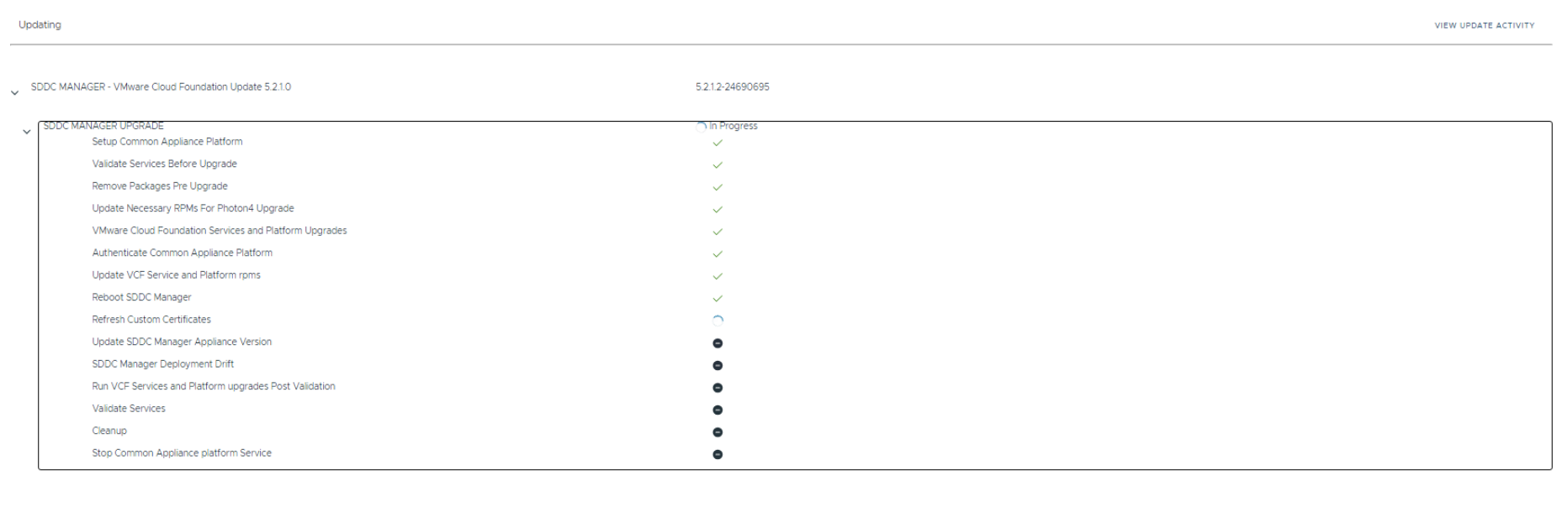

SDDC upgrade fails during the Refresh Custom Certificate
Article ID: 433405
VMware SDDC Manager / VCF Installer VMware Cloud Foundation
  • Upgrade is failing at "Refresh Custom Certificate":
  • SDDC UI stuck at "VMware Cloud Foundation is initializing .."
    Attempt ###/###. Unable to initialize the Ul service due to "Status code 500: Unable to retrieve iDP Metadata: Error executing remote command via SSH: WARNING: Your password has expired. Password change required but no TTY available.". Get help

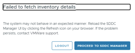

  • SDDU UI is failing with "Failed to Fetch Inventory"

  • VCF 5.2.x
  • VCF 9.x
  • The ownership of /etc/vmware/vcf/domainmanager/application.properties file and /etc/vmware/vcf/operationsmanager/application.properties file is set to vcf_sos:vcf
  • Management Domain vCenter root password expired
  1. File Permission
    1. If the issue related to the file permission follow KB - VCF upgrade fails on "SDDC Manager Deployment Drift stage" with an error "Service Validation Failed"
  2. Management Domain vCenter root password expire
    1. [Workaround 2] Reset the vCenter Server password and update the SDDC Manager database with the new password
