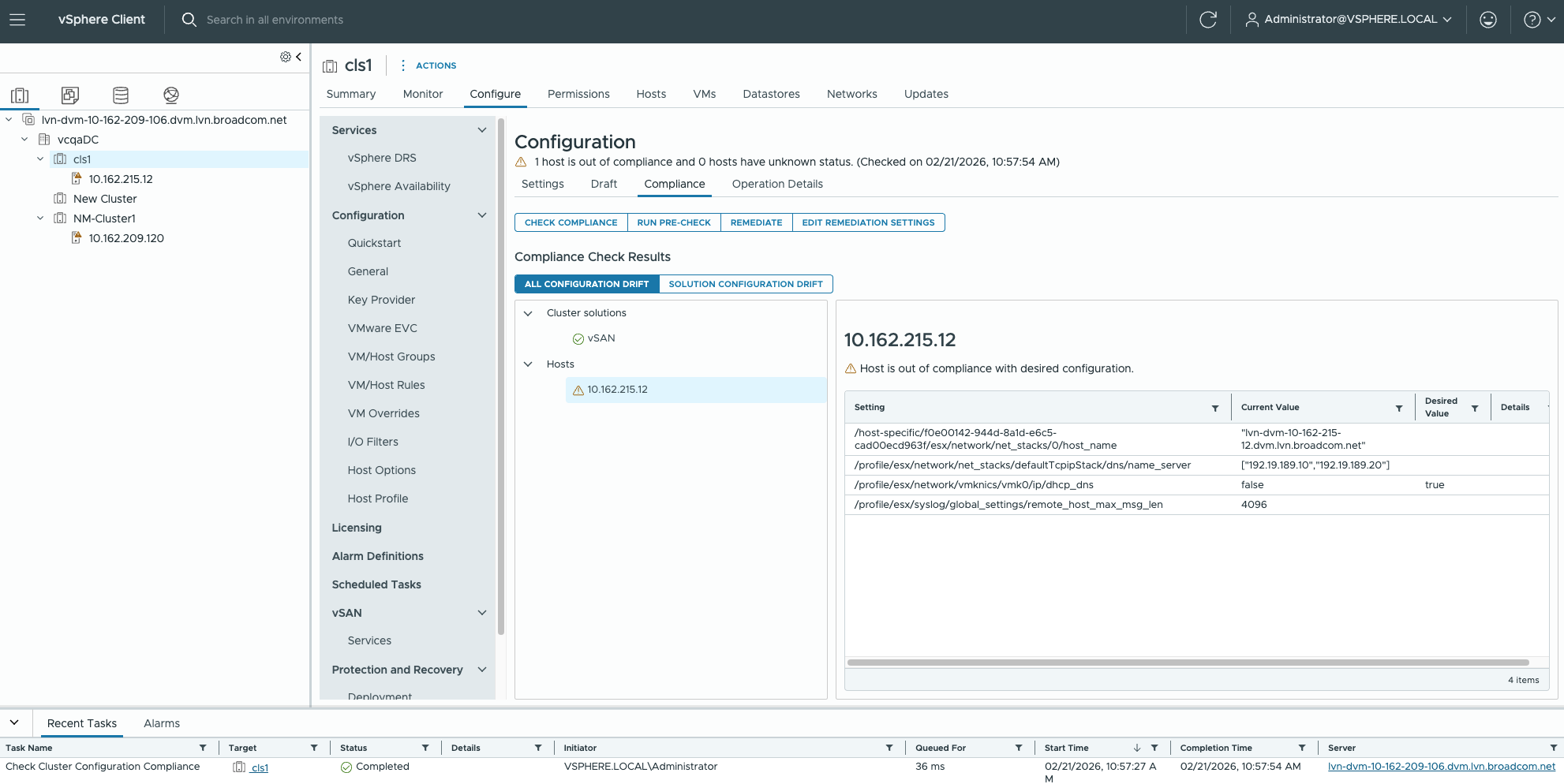

The VCP compliance engine flags a discrepancy in the following path: /profile/esx/syslog/global_settings/remote_host_max_msg_len
While the host remains functional, the cluster status will remain "Non-Compliant" until the drift is acknowledged and absorbed into the desired state.

Following the enablement of Distributed Firewall (DFW) in vSphere 9.1.x and the subsequent remediation of hosts to the desired image, a compliance check (Configure → Configuration → Compliance → Check Compliance) may report a drift for the following parameter: /profile/esx/syslog/global_settings/remote_host_max_msg_len
Reason for Drift Detection
When DFW feature is enabled, the underlying system requires the syslog message length to be adjusted (typically to 4096). During the first compliance check post-enablement, the VCP engine identifies that the current value on the ESXi hosts does not match the cluster’s current 9.1.x global Desired State

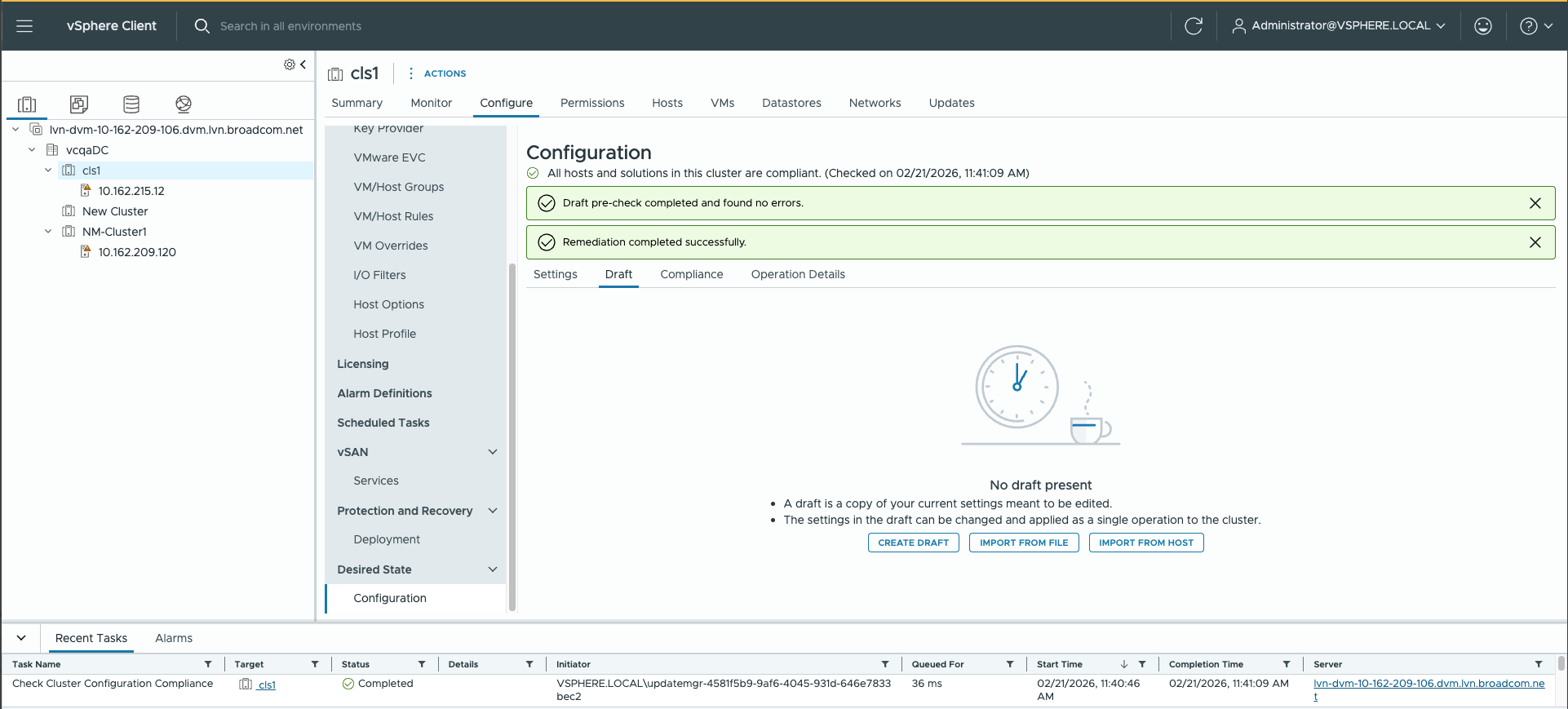

2. Initiate the Configuration Draft

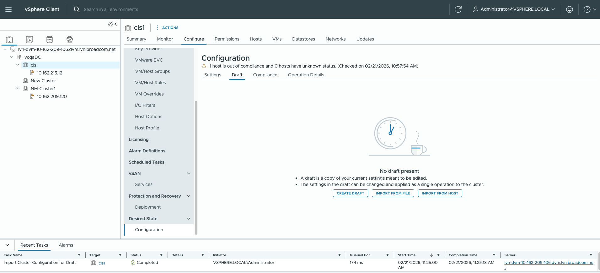

Navigate to the Configure tab → Desired State → Configuration. Click on the Edit button to initialize a new configuration draft.

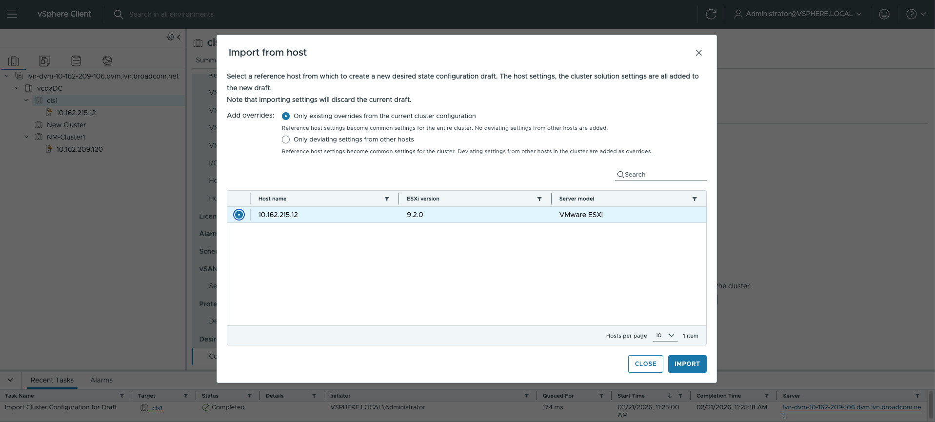

3. Import Settings from the Reference Host
Under the Draft tab, select the Import from Host option.
  • Action: Select a host that currently has the correct settings as your reference.
  • Result: This action pulls the configuration from the reference host and populates it into the current draft, including the required syslog parameters.

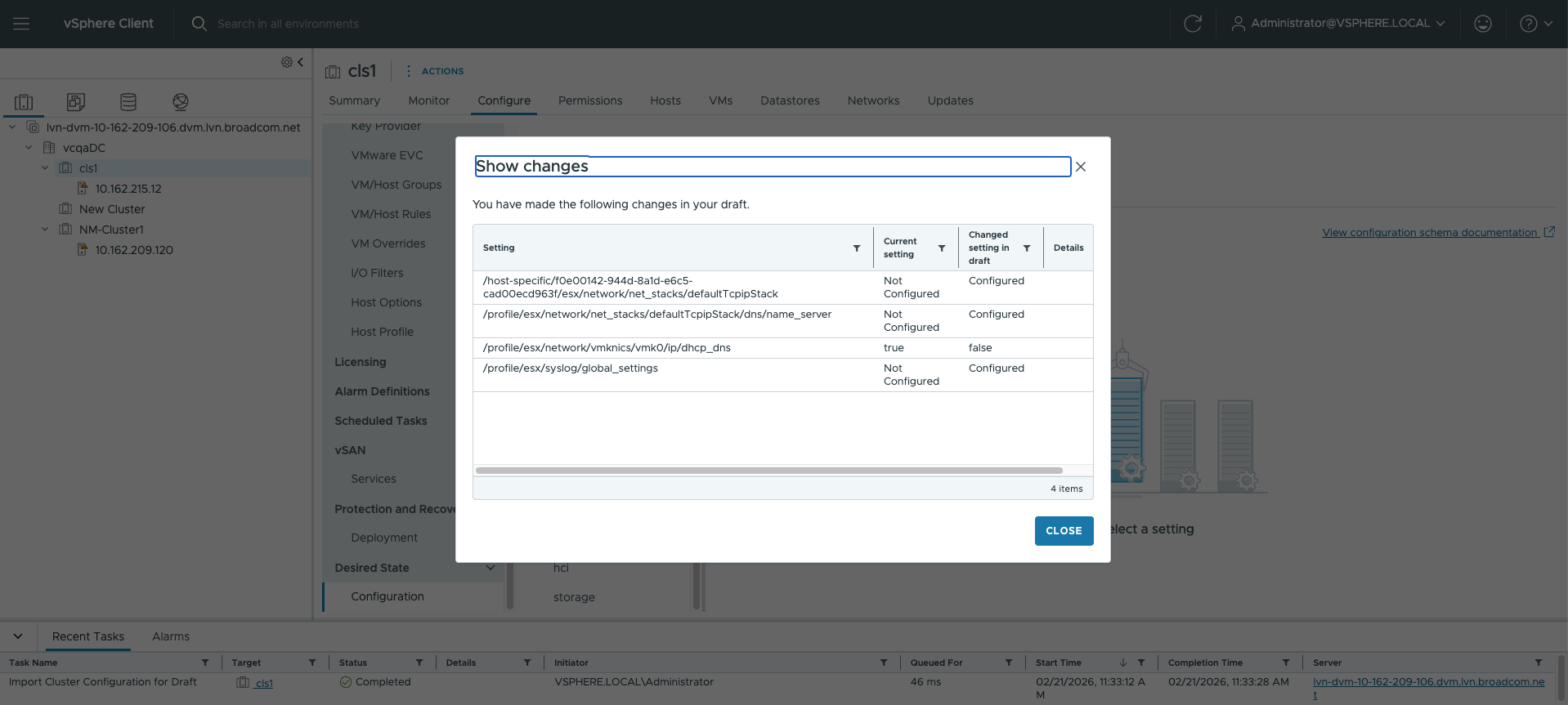

4. Verify and Commit the Draft
Before finalizing, ensure the values are correct:
  • Verify: Within the draft, locate the parameter path: /profile/esx/syslog/global_settings/remote_host_max_msg_len.
  • Confirm: Ensure the value is set to 4096.
  • Commit: Click Save and then select Commit (or Apply Changes) to promote this draft to the active "Desired State."
5. Final Compliance Validation
Return to the Compliance tab and click Check Compliance.
  • The VCP engine will re-scan the hosts against the updated profile.
  • The drift alerts should disappear, and the cluster status should update to Compliant.

2. Select a Reference Host and Create a Draft
Within the Configure tab, navigate to Desired State → ConfigurationSelect the option #2 only deviating settings from other hostsReference host settings become common settings for the cluster. Deviating settings from other hosts in the cluster are added as overrides.
Note: A new draft will be generated using settings from the cluster hosts. You may manually modify the draft at this stage to ensure remote_host_max_msg_len is set to 4096.
3. Review Proposed Changes
Navigate to Configure → Desired State → Configuration → Draft → Show Changes. Use this view to compare the newly imported draft against the cluster's current Desired Configuration. This ensures only the intended syslog changes are being absorbed.

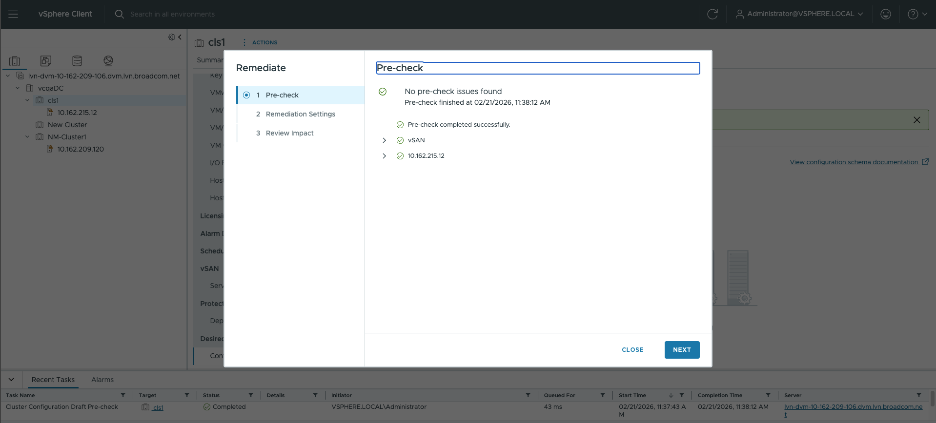

4. Apply and Commit the New Configuration
Select Apply Changes (or Commit) to save the draft as the new cluster-wide Desired Configuration.
Note: This action will trigger an automatic Remediation operation across the cluster to align all hosts with the new profile.
5. Verify Cluster Compliance
Once the "Apply" task completes, a Check Compliance operation is triggered automatically. The hosts should now report a status of Compliant, and the syslog drift alerts should be cleared.
