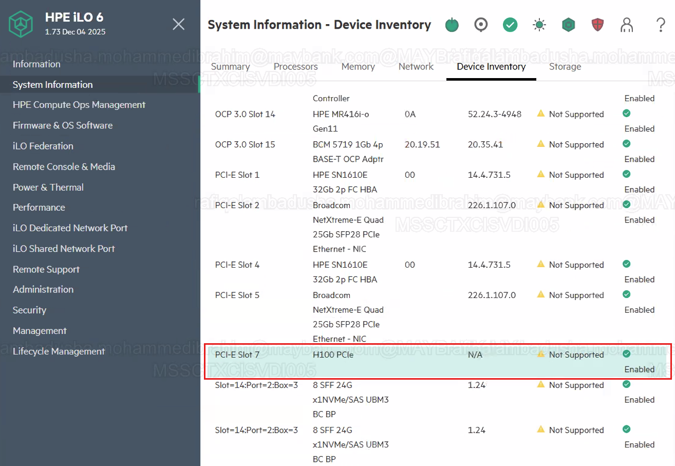

  • The GPU firmware and device details are missing from the physical server's Remote Management Console (e.g., iLO, iDRAC, or IPMI) during POST.

  2. Access the remote console and monitor the POST sequence to verify if the NVIDIA GPU is detected during hardware initialization.
  3. Verify the GPU firmware details are actively displayed in the iLO console.
  4. If the hardware remains undetected by the baseboard management controller, engage the hardware vendor to review physical hardware logs or investigate potential physical seating or fault issues with the GPU card.
